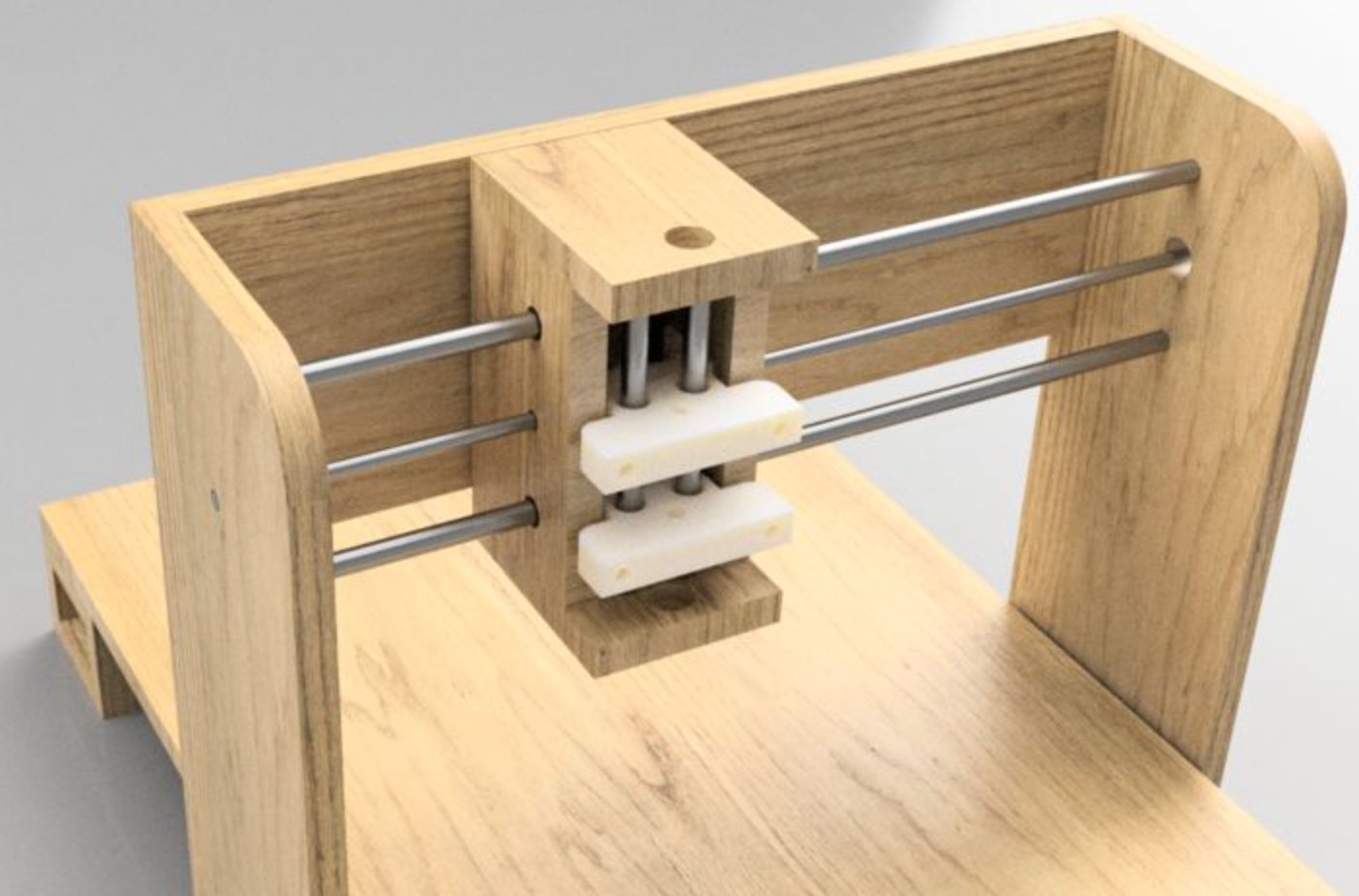

Step 2: The Design
As explained in the introduction, my hardware design is based on the Arduino CNC instructable, that I found here. Since no exact dimensions etc. were given in this instructable, I made the design all by myself again in Autodesk's Fusion 360.
I designed it to have a range of ±70cm in y-direction, ±40cm in x-direction and ±10cm in z-direction.

Step 5: Z-block Assembly
One of the most difficult part is the Z-block. Drilling of the holes has to be very precise, otherwise the friction will be too high, since the steel rods won't be perfectly aligned with the holes in the side panels of the x-assembly. My tip is to use a mitre saw to cut the wood and a drill press to make the holes! For the larger holes, I first used a drill press to make a start and then a router to make enough space.
All black parts in the design are 3d printed, since it's easier to gain high accuracy then. Those parts can be found on the thingiverse link from the previous step. The white thingies are the nylon bearings.
The wood needs to be sawn and drilled as shown in figure 2.
