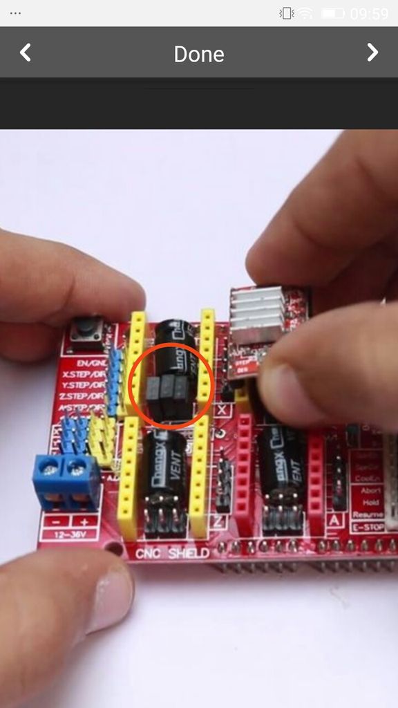

Question 4 years ago
Sir what dud you inserted the black things
0
AtharA5
AtharA5
Answer 3 years ago
Those are called jumper caps
0
MohmmedA7
MohmmedA7
Answer 3 years ago
Its a jumper
0

SumanS51
SumanS51
4 years ago
Sir, what did you insert there...
That black things...
0
MohmmedA7
MohmmedA7
Reply 3 years ago
Jumper
