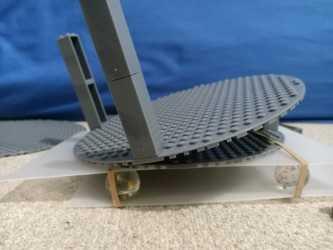

- Assemble your shake table using the below steps:
STEPS FOR ASSEMBLING SHAKE TABLE:
a) Place the two plexiglass sheets on top of one another.
b) Stretch a rubber band around each end of the plexiglass sheets, about 1 inch from the edges.
c) Insert the rubber balls between the boards at each of the 4 corners, placing them directly under the rubber bands - to help prevent the sheets from bending.
Your shake table is now assembled!
2. Attach the Base Plate to the top of the shake table. Secure the Base Plate by slipping it underneath the rubber bands.

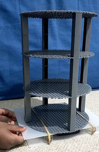

3. Build a series of towers using the Strictly Briks on top of the base plate. The only difference between each structure should be their height (keep it in mind, that the tower’s footprint must remain the same).
4. Measure the height of each tower using a measuring stick.
5. Next, measure the distance of the table displacement:
6. Lastly, use your phone to measure the ‘earthquake’ strength using your phone, to replicate the use of a seismometer (which is a scientific tool used to measure the earthquake strength). I used an app called “Arduino Science Journal” to do this. To measure the force you applied to the Shake Table, you could build a space for your phone on top of the plexiglass. This step is not entirely necessary and is only there for keeping in with my control variables: applying the same amount of force each time.
7. Finally, keep a record of your measurements in a table & plot all your variables onto a graph.

In my hypothesis, I predicted that my tallest structure (which in this case was 30cm) would take the least amount of time to collapse. This was proved by the mean amount of 19 seconds that the 30cm structure took when compared to the 33.3 seconds of the 20cm structure and 43.6 seconds of the 10cm structure. From these mean results, we can also see that the 10cm structure withstood my shake table for the longest period of time: 43.6 seconds. All of this evidence is proved to be fair, as one of my control variables was to repeat this same experiment 3 times. So I believe that this proves that my hypothesis is correct and also provable through a practical.

Out of all of the results I produced during this experiment, the largest difference in time had a maximum of 9 seconds, which provides a controversial aspect to how equal and fair I tried to make the tests. Fortunately, the large time difference is only true with the 20cm structure. Meanwhile, the 10cm and 30cm structures have a difference of 4 and 5 seconds (in that respective order) between their shortest and longest times taken to collapse, which shows that the experiment was largely accurate. Thus, I believe that the project had a repeatable aspect to it and that more repeats were unnecessary. Although, if I was offered to repeat the experiment with one of the 3 buildings again, I would test the 20cm structure again.
I also believe that this experiment is reproducible - as in I or another person could repeat this experiment using similar materials and obtain similar results. Unfortunately, this cannot be proved as I do not know of another person doing this same experiment & buying different materials to construct another Shake Table appears to be both time-consuming and resource-consuming. But I can predict this through a similar contrast of results based on height differences which I have found online, on a website called Science Buddies.
Although my results, fortunately, turned out to be mostly similar, I found difficulty in finding suitable materials. First, I discovered that Lego was very difficult to destroy. Then, I discovered that the plexiglass I was to use, was actually rather too small to fit my phone (on which I am recording the force applied to my Shake Table). This meant that I had to make quite a few drastic adaptations to my method. First, I substituted Lego for Strictly Bricks and a structure that was easier to destroy. Next, I tried placing my phone in different sections on the top of my Shake Table. Every time I tried this, it weighed down a certain side of the Shake Table, making the test unfair. In the end, I decided to place the phone underneath the Shake Table. Regrettably, this meant that the vibration measuring app couldn’t measure the force I applied, to its highest potential. Perhaps next time, I could search for a larger piece of plexiglass to help measure the force better.
Lastly, I was finally able to access what minuscule amount of force my phone was able to measure. There, it showed that the shake table moved at an average of -0.1m/s², 0.1m/s², -0.09m/s² (for the 10cm, 20cm, 30cm structures respectively). This signals that the Shake Table virtually distributed the force equally (with 0 being perfectly distributed). Also, as I pulled my hardest on each of the structures (to try making each of the tests as fair as possible), every single of my 9 tests began with “7.5m/s² & -7.4m/s²”, which I found to be a highly notable mention.
