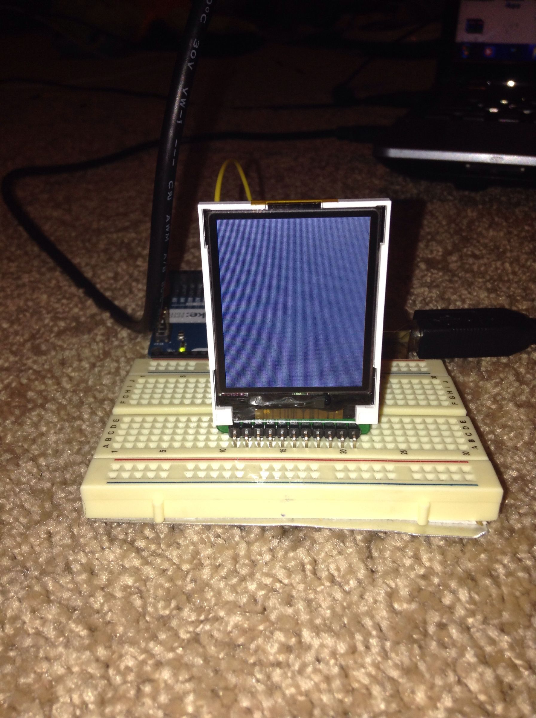

Step 2: Shift Resistor
The picture will tell you what to do for the wires and the components
