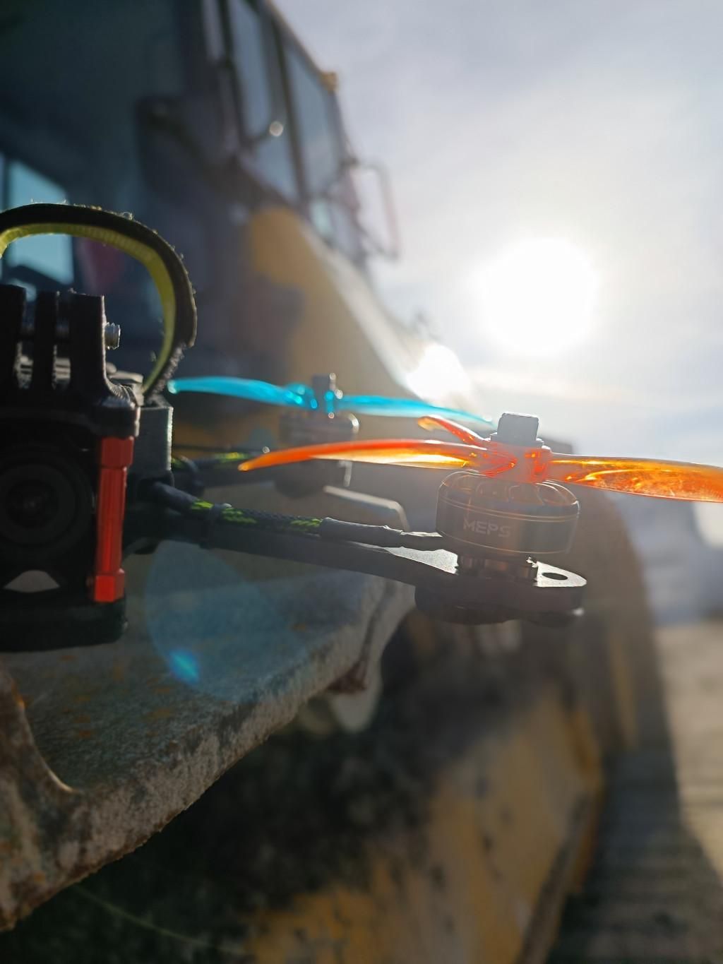

Step 1: Frame
Similar to a car's chassis, the primary function of a drone's frame is to provide structure and form. Considering all the controllers on board, your frame's design may not seem like the smartest component of your quad, but it can be. You can really see the difference in quality between different frames by the way that designers consider mounting places for various accessories, such as gopros and batteries, and how these pieces are distributed in terms of weight.
Step 2: Motor
Your quad's motors perform the crucial function of turning the propellers, which provides thrust and allows you to control where the vehicle goes. There are a few specs to consider when thinking about a motor:
The ESC provides a rating for the motor's RPM per volt, which is known as the Motor KV. To make sure you don't burn out your motors by requesting too much torque, you should investigate the optimal KV for the weight and form factor of your drone.
The dimensions of the motor and the mounting. The motor size is typically expressed as a four-digit number, such as "xxyy," where "xx" denotes the stator's width in millimeters and "yy" denotes its height in millimeters. The torque a motor can generate is directly correlated with its size.

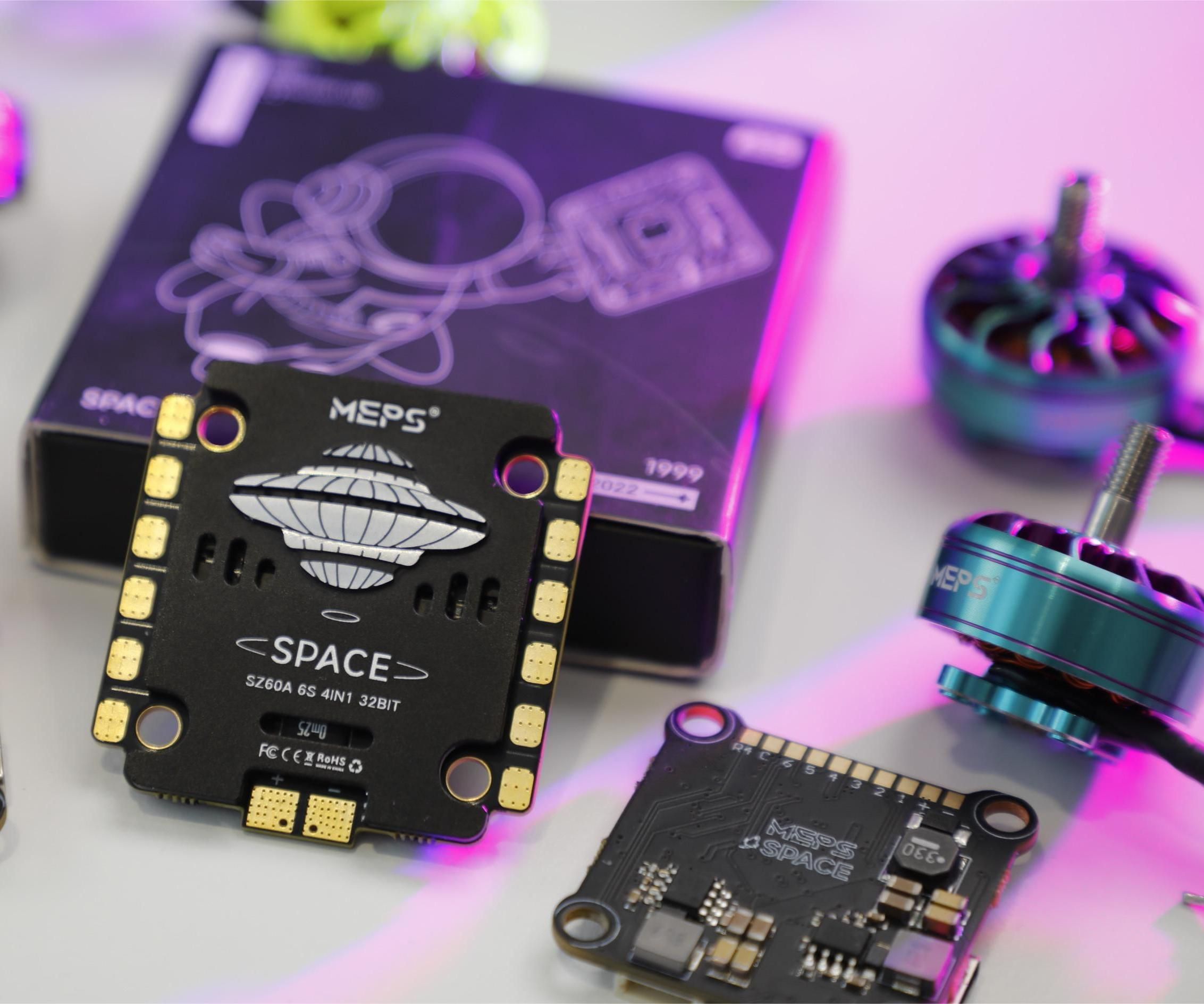

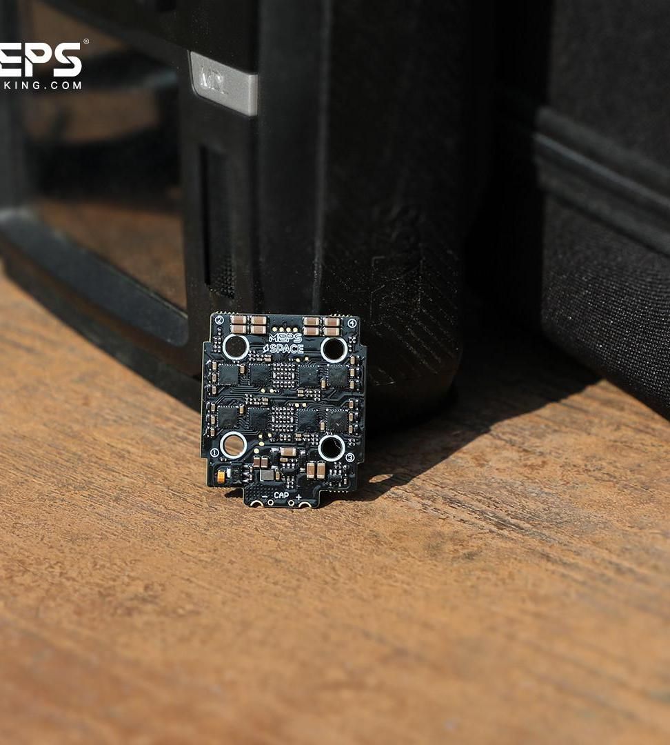

Step 3: ESC
An electrical device known as an ESC, or electronic speed controller, regulates the voltage applied to the motor, which in turn regulates the motor's rotational speed and the thrust the propellers produce. These days, it is not unusual to see boards with the power distribution components and hardware for all four ESCs on them. The input voltage and maximum output current ratings are crucial factors to take into account when selecting an FPV drone ESC. The voltage of the battery in your quad needs to be included in the input voltage range (4s, 6s, etc). Additionally, the maximum current must be greater than the motor's peak current that the ESC is managing.
Step 4: Flight Controller
The brains of the operation are the quadcopter flight controllers, which instruct the ESCs on what voltage to supply to each motor. When in an assisted flight mode, such level or horizon mode, it uses its own internal computation to compute the voltage. also picks up the signals you send it using your transmitter via the linked receiver's interface. Here I would love to introduce one of the best FPV flight controller — MEPS F7.
