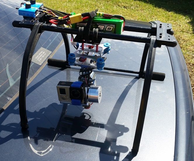

- This is not mandatory but in my case the ESC replacement didn't come with bullet connectors, under my situation I cut off the bullet connectors from my old ESC and soldered them to the new ESC.

If the motor spin doesn't correctly switch the brushless motor A and C wires and repeat step 11. In reference to the photograph above it is the polarity wires (red and black) of brushless motor.
