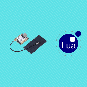

Introduction: How to Code With Lua on ESP32 With Xedge32
About: Keep improving every day, and help others improve too.
Welcome to our latest tutorial, where we dive into the powerful capabilities of the Xedge32 platform and demonstrate how to code the ESP32-S3 using the Lua programming language. Xedge32 is an advanced iteration of Xedge, designed to significantly accelerate IoT device development with its comprehensive peripheral Lua API for the ESP32. By leveraging the high-level, user-friendly Lua language, Xedge32 makes it easier than ever to integrate IoT functionality into your projects without the need for C coding.
In this tutorial, we will guide you through the steps of using Xedge32 to write scripts for the ESP32-S3, showcasing its streamlined approach to working with device components such as sensors. Whether you are new to Lua or an experienced developer, you'll find valuable insights and practical examples to help you get the most out of this powerful combination.
