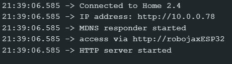

Step 1: Connect ULN2003 Driver Board to ESP32
Connect IN1 To Pin 13 On ESP32 (Could Also Be D13 Or G13)
Connect IN2 To Pin 12 On ESP32 (Could Also Be D12 Or G12)
Connect IN3 To Pin 14 On ESP32 (Could Also Be D14 Or G14)
Connect IN4 To Pin 27 On ESP32 (Could Also Be D27 Or G27)
You Can Either Connect The Positive And Negative To The 5V (As VIN On ESP32) And The GND On The ESP32 Or You Can Use A Separate Adapter For 12V To Make It More Powerful

Serial.begin(115200);//initialize the serial monitor
Serial.println("Robojax 28BYJ-48 Stepper Motor Control");
//Robojax.com ESP32 Stepper Push button Any Angle ESPSTP-2
WiFi.mode(WIFI_STA);
WiFi.begin(ssid, password);
Serial.println("");
// Wait for connection
while (WiFi.status() != WL_CONNECTED) {
delay(500);
Serial.print(".");
Serial.println("");
Serial.print("Connected to ");
Serial.println(ssid);
Serial.print("IP address: http://");
Serial.println(WiFi.localIP());
//multicast DNS //Robojax.com 28BYJ-48 Steper Motor Control
if (MDNS.begin("robojaxESP32")) {
Serial.println("MDNS responder started");
Serial.println("access via http://robojaxESP32");
server.on("/", handleRoot);
server.on("/go", HTTP_GET, motorControl);
server.on("/stop",HTTP_GET, stopMotor);
server.onNotFound(handleNotFound);
server.begin();
Serial.println("HTTP server started");
}//end of setup

After You Upload The Code Open Serial Monitor By Pressing CONTROL+SHIFT+M Or By Going To TOOLS Then Serial Monitor. Make Sure The Baud Is Set To 115200
Step 6: Next
After You Open Serial Monitor Unplug Then Plug Back In Your ESP32 You Will See A Link Go To That Link And You Will See The Image Above
