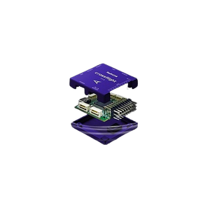

Step 2: Overview of Cross Flight Controller
The Radiolink Crossflight Flight Controller is an advanced and reliable system designed to control drones and unmanned aerial vehicles (UAVs). This cutting-edge solution combines high-performance hardware with intelligent software to provide precise flight control and enhanced aerial capabilities. With 10 channels of PWM output, it can be adapted to 3-8 axis multi-rotors, airplanes, helicopters, cars, boats, and multiple industries.
The Radiolink Crossflight Flight Controller has a compact and lightweight design, built with high-quality materials for durability and long-lasting performance. It is suitable for both hobbyists and professional drone pilots who aim to push the boundaries of their aerial missions.

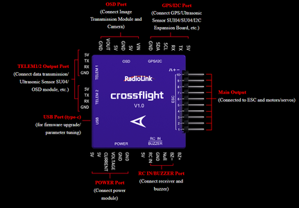

Step 3: Servo Connection With Crossflight Flight Controller

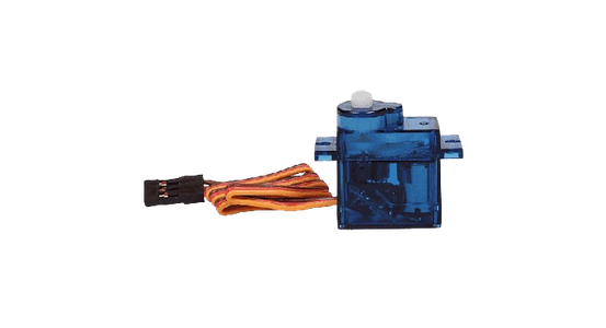

Radiolink Crossflight has 10 channels of PWM output. For quadcopter, channels 1 to 4 are connected to the 4 main motors/ESC. We connect a servo motor to channel 6 of the flight controller.

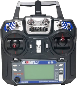

Step 4: Setup Flysky FS-i6 for Servo and Assign Switch
1) press ok button for 3 seconds.
2) Go to setup using the up and down button and press ok.
3) Go down to Aux. channels using the down button and press ok.
4) Choose channel 6 by pressing ok
5) Change the source to SWD using up and down button.

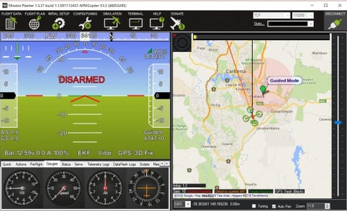

Step 5: Mission Planner Setup
1. Connect the mission planner with the flight controller.
2. Click on the "Setup" button located at the top of the window.
3. Navigate to the "Mandatory Hardware" section.
4. Search for the "Servo Output" option and select it.
5. For channel 6, change the function from "disabled" to "SERVOn_min".
