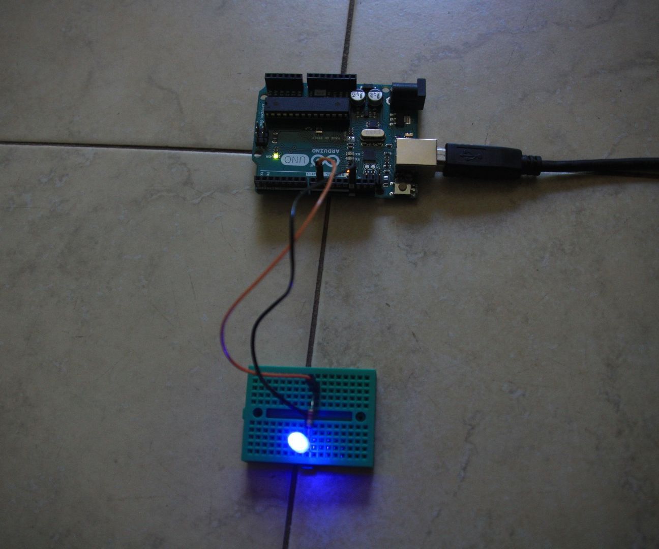

Step 5: Connecting the Wires to Your Arduino
Finally, you're going to need to connect all the wires to the Arduino's corresponding pins. The ground wire from the led connects to the GND pin on the Arduino, and the colored pins connect to pins 9,10, and 11 on the Arduino. It should look like the diagram above.

Step 9: Yay!!!
If you did everything right, the led should now be fading through all the colors!
