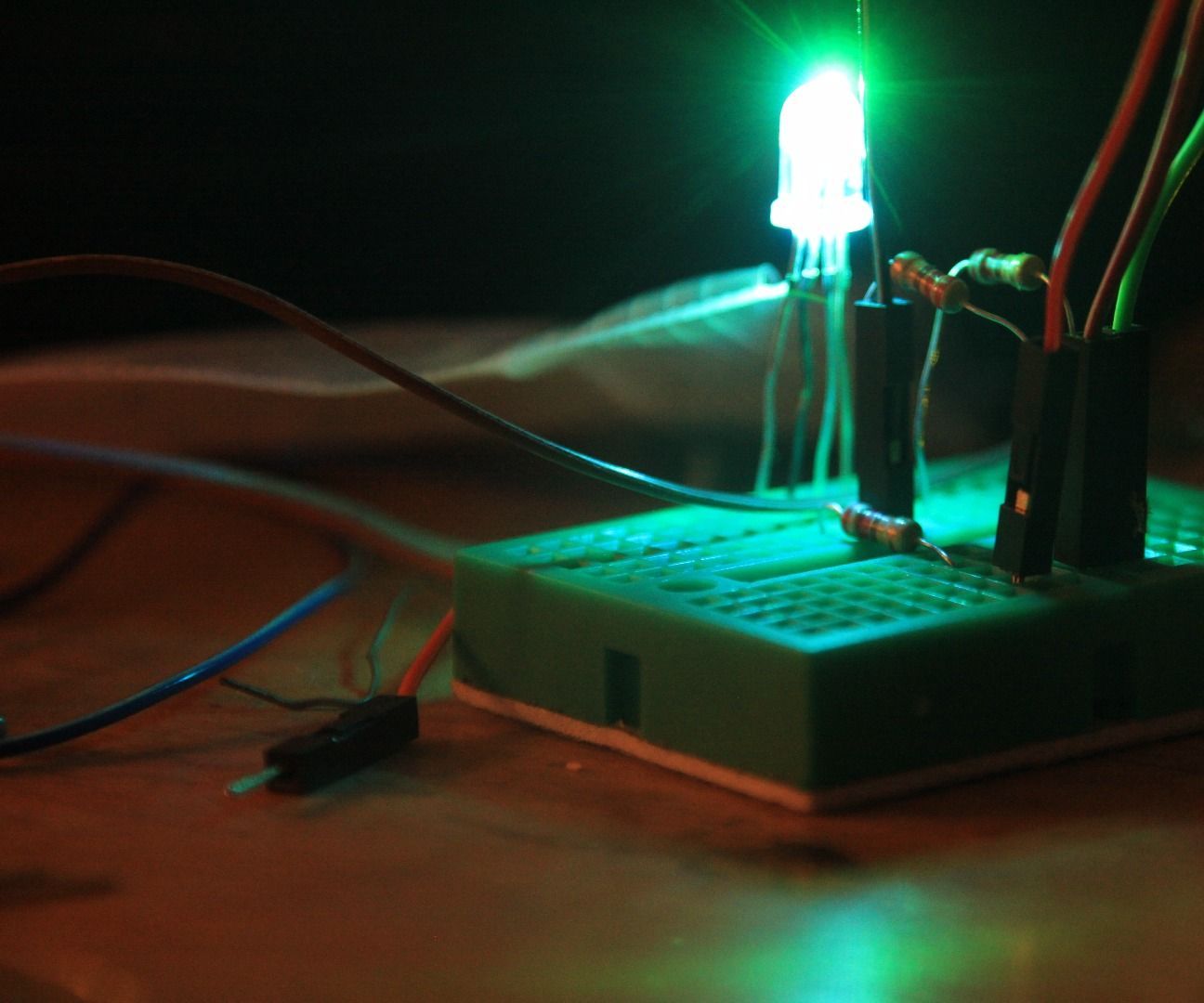

Step 2: Attach the Ground Wire to the Arduino
Attach a jumper wire to the ground (GND) output pin on the Arduino.
Step 3: Attach a Jumper Wire to Pin 9 on the Arduino
Next, attach a jumper wire to Pin 9 on your Arduino.
Step 4: Breadboarding!
Now get out your breadboard out and attach the ground wire.
Step 5: Pin 9 Wire
Now take the wire leading from pin 9 on the Arduino and attach it behind the non-conductive space in the middle of the breadboard.
The reason for this is because the Arduino does not have a built-in resistor leading out of Pin 9, you will need to put one in of your own. Putting the Pin 9 wire on the other side will keep it from burning out your LED and will provide enough space to comfortably fit the resistor in.
Step 6: Insert the 220 Ohm Resistor
Now insert the resistor from the pin 9 wire an plug the other end beside the Ground wire.
Step 7: The LED
Now attach the LED on the breadboard.
Step 8: Plug in the Power!
Now plug in the Arduino into your computer. The board will power on, but the LED will not light up...not yet.
Step 9: Upload the Code to Your Arduino.
Open the Arduino IDE software, assuming you have already downloaded and installed it. (You can get it for free from: www.arduino.cc/en/Main/Software
Navigate to File>Examples>Basics>Fade. The script is included in the install, but if you do not have it, here it is.
FadeThis example shows how to fade an LED on pin 9 using the analogWrite() function.This example code is in the public domain. */int led = 9; // the pin that the LED is attached to int brightness = 0; // how bright the LED is int fadeAmount = 5; // how many points to fade the LED by// the setup routine runs once when you press reset: void setup() { // declare pin 9 to be an output: pinMode(led, OUTPUT); }// the loop routine runs over and over again forever: void loop() { // set the brightness of pin 9: analogWrite(led, brightness);// change the brightness for next time through the loop: brightness = brightness + fadeAmount;// reverse the direction of the fading at the ends of the fade: if (brightness == 0 || brightness == 255) { fadeAmount = -fadeAmount ; } // wait for 30 milliseconds to see the dimming effect delay(30); }Now upload the code to your board.
Step 10: Congratulations!
If you did everything right, after a few seconds, the led will begin to fade.
