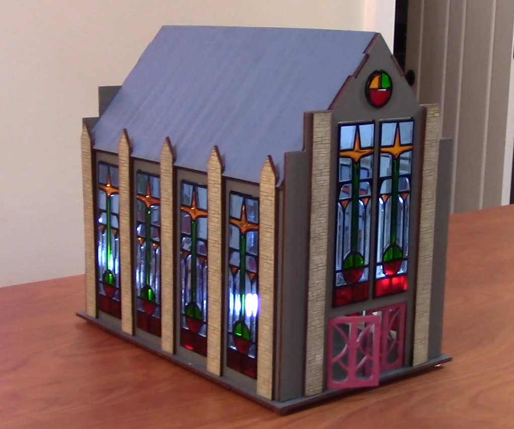

Step 7: Laser Cut the Pieces
Laser cutters are setup to execute engraving before cutting, so the brick will engrave before the windows and doors are cut and the walls are cut out. The single longest cut time in this design is for the facade sheet, which took about 45 minutes.
I cut several different options for my skylights: 1/8" florescent green, 1/4" clear and 1/8" frosted. I always like to test different things just to see what I like best during final assembly.
Step 8: Paint the Pieces
After all the time and effort that went into the brick pattern, it would be a shame to cover it all up with paint! I tested several different paint-to-acrylic-glaze ratios before settling on one that gave me a nice golden glaze that let the engraving shine through.
The floor and the roof were painted with a gray and white mixture that I applied directionally, giving the surface a slate or metallic look.
The facade and ornate roof front were painted with full strength Citadel paints. I use Citadel paints to paint my miniature WarmaHordes models, so I used a color palette that matched my army.
Step 9: Assemble the Model
The first thing I did is glue the facades onto the walls.
Next I built the first floor, gluing the tabs into the floor and the butt joints on the walls.
You want the floors to remain detached and modular, so I built the second floor separate from the first. Because the tabs stick through the bottom, I placed shims under the balconies so they had something to rest on while I built the balcony railings. The tabs, when eventually slotted into the walls of the first floor, will be hidden by the facade on the first floor walls.
Then I assembled the roof.
Finally, I glued the two functioning doors in place by using scraps of leather as hinges.
Step 10: The Model Is Finished!
After trying the three skylight options, my favorite was the frosted skylights (though all were nice).
The puck lights fit easily inside the building and look great when lit.
