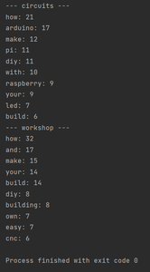

most_common_words = word_counts.most_common(10)
for word, frequency in most_common_words:
print(f"{word}: {frequency}")

The code combines web scraping, data preprocessing, and data visualization techniques to extract project titles, analyze word frequencies, and generate a bar chart comparing the most common words across different categories of project titles.
