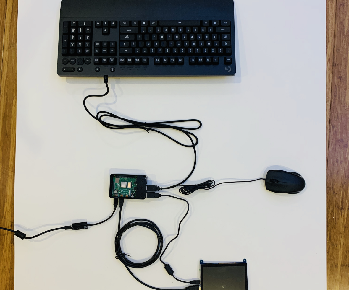

Raspberry Pi completed with Screen (you can use a TV or and monitor you have), Keyboard and Mouse
Raspberry Pi Camera
Wifi
