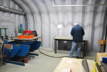

First of all, ensure that the workplace is clean and ready for welding. Tables must be flame resistant, preferably made of steel or stainless steel. Be sure that there are no flammable objects near the welding area. Place the welder in a place that is out of the way and will not be damaged. Use proper safety gear including gloves, helmet, and jacket.

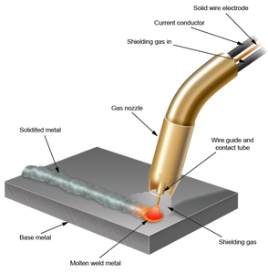

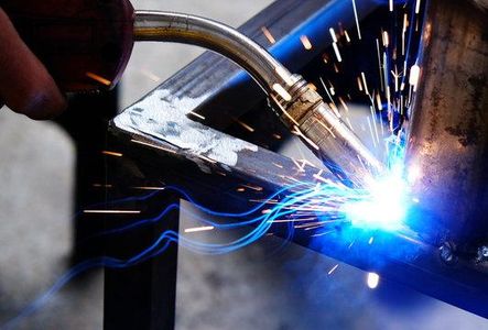

Next, pull the trigger on the welding gun and be sure the gun is working properly. Wire and shielding should be seen/heard coming out of the gun. If the gun is operating correctly, welding can begin. Place the desired metal pieces in their proper orientation and hold the gun a quarter inch away from the joint(s). Pull the trigger and let a pool of molten metal accumulate. Then, using small and consistent strokes, move the gun along the seam using a recommended pattern. Recommended patterns include making a continuous string of cursive E’s, making repetitive half moons, back and forth motions, or a wave like motion. These are trial and error methods, some may work better than others for certain applications. There are other ways to lay beads of weld as well, but these are the most common.

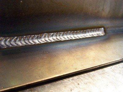

        Finally, once the weld is run along the seam, make a small pool of metal at the end of the weld and let go of the trigger. Hold the gun still until the gas turns off. The weld is now complete and the bead should look like the picture. THIS WILL TAKE PRACTICE. The ground clamp may be removed. Turn the welder off and ensure the shielding gas is off as well. The welder may be unplugged and placed back into the place of origin. The welding process is now complete!
