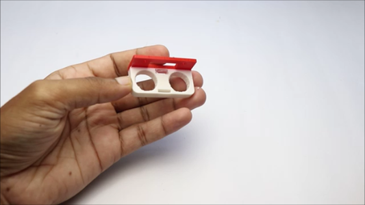

  • 3D printed case for ultrasonic sensor module(optional)

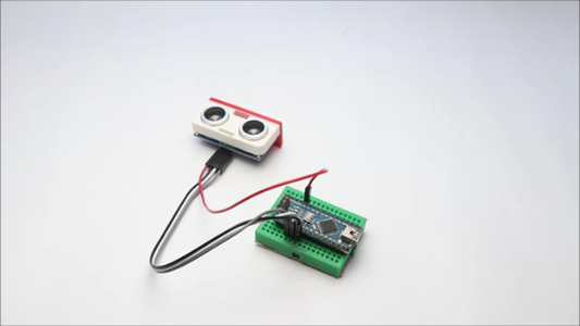

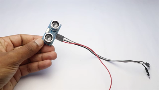

After we have all the components ready we can proceed with building the circuit, and start by connecting the wires of the ultrasonic sensor to its pins.

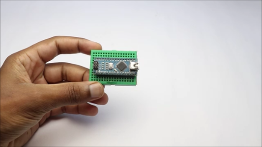

Add the Arduino nano to the breadboard and start connecting jumper wires, Trig to D2, Echo to D3, Gnd to Gnd where as Vcc to 5v pins on the nano.
Wires of micro servo Gnd to Gnd of nano, Vcc to 5v pin, and the servo signal pin to D9 of nano.
After this is done we can connect the wires of the micro servo to the breadboard.
You can also use a small breadboard rather than this mini breadboard if you don't have this, purpose is just to make the project as small as possible.
This is a very simple circuit and can be expected to be completed in less than 5 minutes.

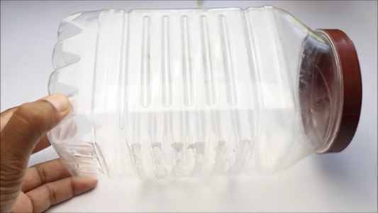

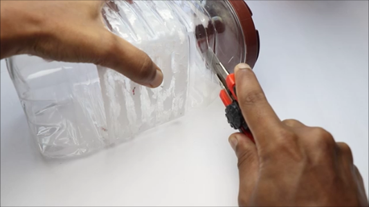

Cut the front part of the container, I found that using this part comes with a lot of advantages the first being the strength
Second is visibility, Start by cutting the front part, and make sure your container is also square in shape, a round shape does not work for this project.

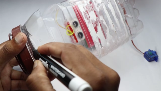

To increase the strength I will add a small piece of wood, this also acts as a holder for electronic components.
Use hot glue to stick this piece of wood, and later make a slot for the ultrasonic sensor by marking and later cutting those.
Paste the breadboard on this wood, use hot glue if you think it's necessary.
Before gluing these make sure you are adding an elastic band.
My size bands are small, so I had to combine two of them, if you have a large one can replace two.
Use hot glue to fill the edges if any when you are adding this holder.

I marked a small dot on the tip of the jar and made a small hole, the elastic band that we added earlier will be coming here.
This is tricky, use a small piece of fishing wire to insert the elastic band into the hole and lock it with a toothpick or a screw.

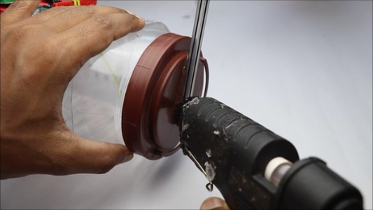

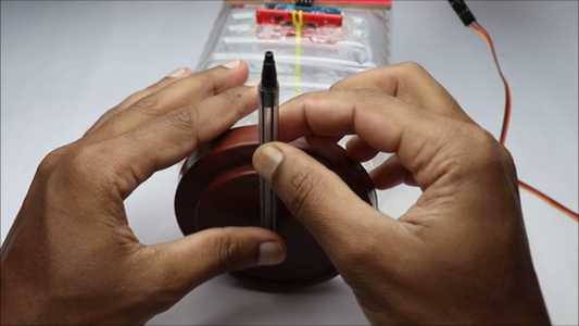

Now for the stick part, I used an old pen tube that was strong.
Use hot glue to stick this pen to the lid of the jar, and test if the lid closes after you open it with good force.
If it works add one more elastic band, this will be the stick holder that plays the role of trigger.

Test if the stick functions smoothly and there are no gaps in the jar when the lid is closing.
You can refer to the first visual that shows the locking method.

Pull the pen down, this is like pulling a catapult but with very less force, after you pull the stick/pen hook the rubber band on its tip.
Now the steel wire from the micro servo horn will be attached to this elastic band.
