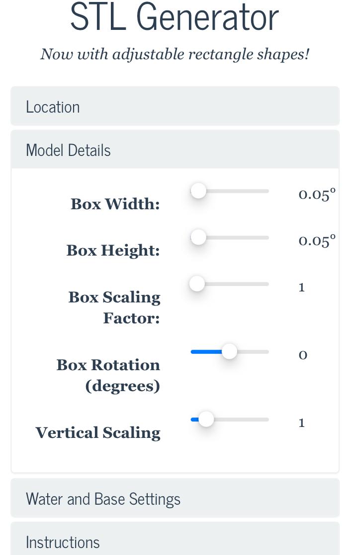

Step 1: Terrain2STL
Open terrain2STL at jthatch.com/Terrain2STL/ you’ll be greeted with this interface.
Step 2: Find the Coordinates of Your Area
This is by far the easiest step, search up the coordinates and write them down, remember that N and E are positive, whilst S and W are negative.
Step 3: Finding Your Area
After entering your coordinates you should see a small red dot, zoom in and you’ll find your area.
Step 4: Generating the Model
Open model details on the side panel. You’ll probably have to make it smaller by adjusting the size, and dragging the box over your area, if it’s a very flat area, and you want to make it more visually interesting, you can increase the vertical scaling, but be careful because at high values it becomes spiky. Then press generate and download the model.
