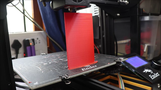

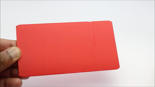

This is an optional step if you don't have a 3d printer you can directly skip this part and carry on with the next step, But those creative people who are still reading this let me explain what I did here.
For the motor holder or in other words for the body of the car I used a 3d printed rectangular frame, This does nothing but hold all the electronic components and serve as a base body, I will be using the PLA filament to print this part on my 3d printer.
There are various other alternatives for this, You can use a piece of cardboard or a piece of MDF wood for this purpose the main thing here is the cleanliness of the project that we get by using these materials.
I suggest going either with 3d printing or using some kit that holds the BO motor and wheels.
If you are 3d printing make sure you are using the settings on the slicer like i did(refer last image of this step for the settings)

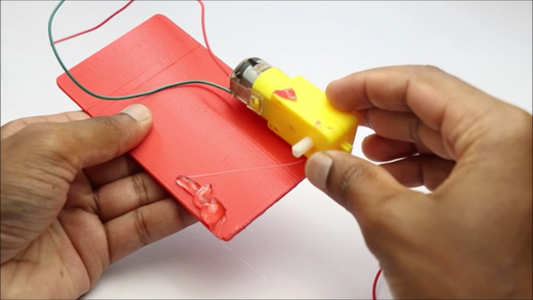

As I mentioned earlier you can use MDF or strong cardboard as a replacement to 3d 3D-printed body.

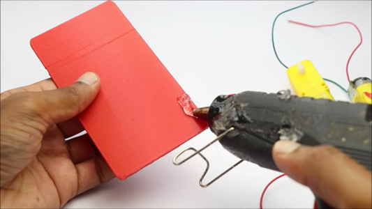

This makes the project look a lot cleaner, start by pasting the BO motor to the base part, I will use good quality hot glue for this purpose, so make sure you are not overheating the glue.
As an alternative, you can also use superglue, But I won't recommend using that because once you glue that it is nearly not possible to take it off and reuse the bo motor in future projects.

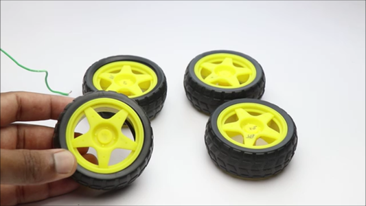

Repeat the same steps for the other 3 motors as well, after this is complete you can connect the wheels to the shafts of the BO motor.
I chose to use the standard type of wheels if you have more budget you can upgrade to a more fancy version of the wheels but I recommend using these standard wheels since they serve the purpose best here.

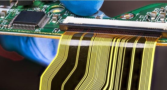

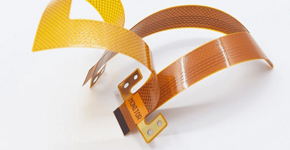

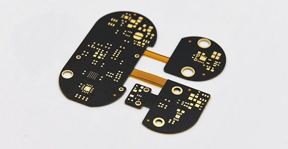

Check Here for Rigid-flex Pcbs with this your circuit becomes flexible! I have added the images to this step kindly check.
A revolutionary solution that combines the best of both rigid and flexible circuitry to elevate your electronic projects to new heights.
With their expertise in advanced manufacturing techniques, they offer a seamless integration of rigid and flexible components, ensuring enhanced reliability, durability, and space-saving benefits

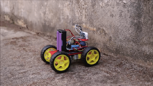

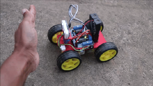

To use this robotic car all you have to do is turn on the power switch and leave it on its own, this will start to move and when an obstacle is detected it will stop and take another direction and even if it detects any sort of obstacle then it changes the path.
The other sides will be continuously scanned by the sensor and servo helps to achieve this and direct the car towards free space.
For the demonstration of how this works, I have added a gif in the front of which a wall is present and our obstacle avoidance car is managing to come back and move in another way.
