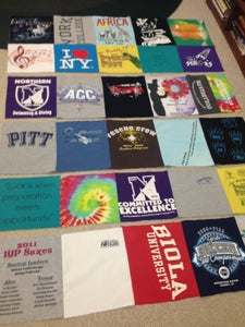

Pick out 30 t-shirts. I only used 26 I think, because I used both the back and front of a few shirts Because we are Indians and we love saving . But basically, you need 30 different pieces of shirt for the quilt squares.

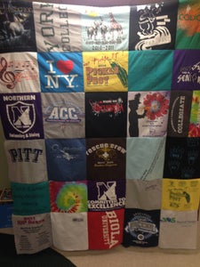

Lay out the shirts in a 5 x 6 fashion that is appealing to the eye and take a picture of it.
Remember that choose the right color and design so that colors and designs co-ordinate with each other

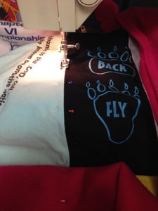

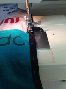

Sew the horizontal rows of the squares together. Here is where your pins come in handy.
a.) Take your first two squares in the top row and lay them side by side.
b.) Flip the square on the right on top of the square on the left, so that the “right” sides of both shirts are touching each other.
c.) Pin along the right side of the square, going through both layers of fabric. Open up the fabric to double check that each shirt is where it should be (i.e. not upside down and pinned together on the correct side).
d.) Sew along these pins. I used the presser foot of the machine as my guide, so it was about an 1/8″ seam. Make sure to take out each pin before you sew over it or else the needle in the machine will bend or break and that’s not good.
e.) repeat this process, adding onto your two connected squares until you have completed the top row of your quilt.

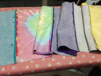

Iron the seams in every row open. Use your pins to hold the seams down and make them nice and flat. Be careful not to burn the interfacing off and don’t melt your pin heads. Basically, I used the tip of the iron and carefully flattened each seam. Yes, it’s very tedious, but necessary.

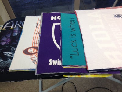

a.) Take the top two rows.
b.) Flip the second row on top of the first row so you’re looking at the back of the second row squares.
c.) Pin along the long bottom edge, doing your best to line up both layers of squares. If you look at my completed picture, I’m sure you can see that mine aren’t perfect but it’s hardly noticeable.
d.) Repeat for the middle 2 rows, and the bottom 2 rows. So now you should have 3 bigger pieces, 2 x 5 each. In the picture above, only the top two rows are connected.
e.) Put together the three large pieces using the same process as before (i.e. flipping the second piece onto the top, pinning and then sewing.)

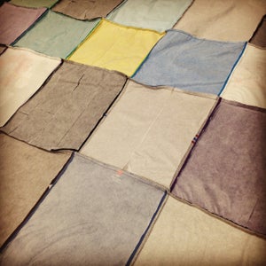

Iron the rest of the seams open. It’s like Step #5, except do the long horizontal seams. This is what the back of my quilt looked like before I ironed down the horizontal rows.

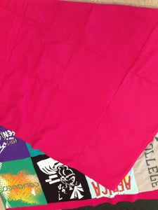

Now Put fleece flat on ground. Place your quilt on top, making sure both layers are as smooth as possible.
Next Find the middle two vertical columns. Pin down both these two seams. So in mine, it was the left and right sides of the shirt starting with the blue Africa shirt, then going down to the yellow pickle shirt, then the black and red orchestra shirt, and so on. When attaching the fleece, you always want to start in the longest middle part and work your way out so it remains as flat as possible, but since there are an even number of vertical lines, pin the two middle at the same time
Step 7: Finishing Step-2
Sew along these vertical lines. This is where your job gets super frustrating and time-consuming, because you have to adjust the material about every five seconds. You don’t want it to get too heavy or stretched in one direction or else the quilt won’t lay flat on the fleece and it’ll be all distorted. Fleece is stretchy, so be careful! Repeat the pinning and sewing process for each vertical row. There’s 4 total.
Now Pin and sew along the horizontal rows in the same fashion as above. Start with the centermost row and do that first, then work your way to the outside. Now the back of your quilt should have a very nice grid on it! And your quilt for the most part should be connected to the fleece, except for the edges. In this picture you can see the pretty grid! Doing all this also adds nice thickness to the quilt overall.

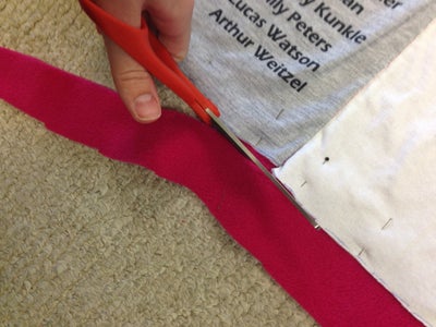

Cut off the excess fleece around the outside so that all the edges are flush. Again, pin everything beforehand so both layers stay nice and flat.

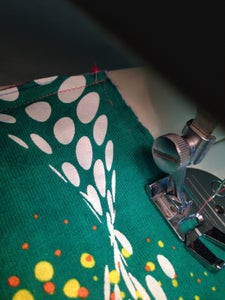

Now Keeping the pins around the entire outside edges, sew a 1/8″ seam around the entire quilt. As you can see from the picture, I did each edge separately, then turned the quilt around and did the next edge. Don’t forget to pull the pins out before you sew over them.
Now it’s time for the last part – the bias tape! Take your bias tape and fold it equally around the outside edges, with half of it on the bottom and half on the top so it covers up all the ragged t-shirt and fleece edges. It’s tricky to make it even the entire way, but just be patient and you can do it!
Sew the bias tape onto the quilt. As much as you can, sew along the inside edge of the bias tape to create a nice rounded edge on all sides of the quilt.
