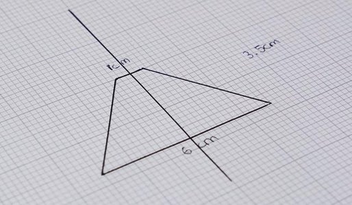

Step 2: Calculate the Size of Your Pyramid
Open Processing and load our code. Run the program and you should be able to see a white square in the middle of screen. Mesure one side of the square and make a cross multiplication to obtain the size of the four parts of the pyramid.
For example, if your square is 2cm large you obtain these results:
Base square : 1cm * 2cm = 2cm
Pyramid height : 3.5cm * 2cm = 7cm
Pyramid upper side : 6cm * 2cm = 12cm
Cut four sides of your pyramid out of your paper sheet and fix them together with a transparent tape for a better result.

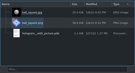

The next step is to make a drawing. Open your favorite drawing software and draw whatever you want in a squared canvas with no background (400*400px).
Save your image in the processing sketch folder that you downloaded before.
Now run the file hologram_with_picture.pde
Processing software should launch. A full code should be visible.
Step 4: Play With the Code
Identify line 23 of the code. You should replace "ball_square.png" with the name and extension of your draw.
By clicking the play icon your image should now be displayed four times on the screen.
