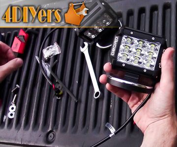

Video tutorial on how to make portable auxiliary lights for your vehicle. For this I am using two flood lights from Oedro, 4 inch 27 watt led light from their Brave Man T1 series. These particular portable auxiliary lights can be mounted anywhere on your vehicle, trailer, recreational vehicle, and possibly boat, however these use a magnetic base so they can only be stuck to steel components. These lights are perfect for working on your vehicle, camping, farming, going out on the trails, loading a vehicle, etc. They use a 12v power supply from your vehicle, receiving power from a cigarette light socket, but you can always install battery post clamps instead depending on your preference.

Remove the brackets on the lights to install the fasteners. As you can see these particular brackets also have a horizontal adjustment which is handy for work lights.
Install the center fastener, Oedro does supply the hardware but I found the center bolt was too long so I used a couple I have laying around instead. You can apply some threadlocker if you wish to these bolts. Ensure the head of the fastener will not interfere with the surface it’s mount on too.
Reinstall the lights on the brackets, I may switch these socket head bolts out for hex heads as I can’t really get my allen key in there to tighten them. For the most part I won’t be using this setup on a moving vehicle so they’ll experience minimal vibrations.
Step 5:
Now for a quick demo, they mount perfectly on top of the box, we can face each light in opposite directions and even alter the horizontal angle of the beam. The switch wire is long enough I can leave it outside of the vehicle. The lights can even pick up a power source from a trunk area in a vehicle and the switch wire is long enough to reach to the driver.
