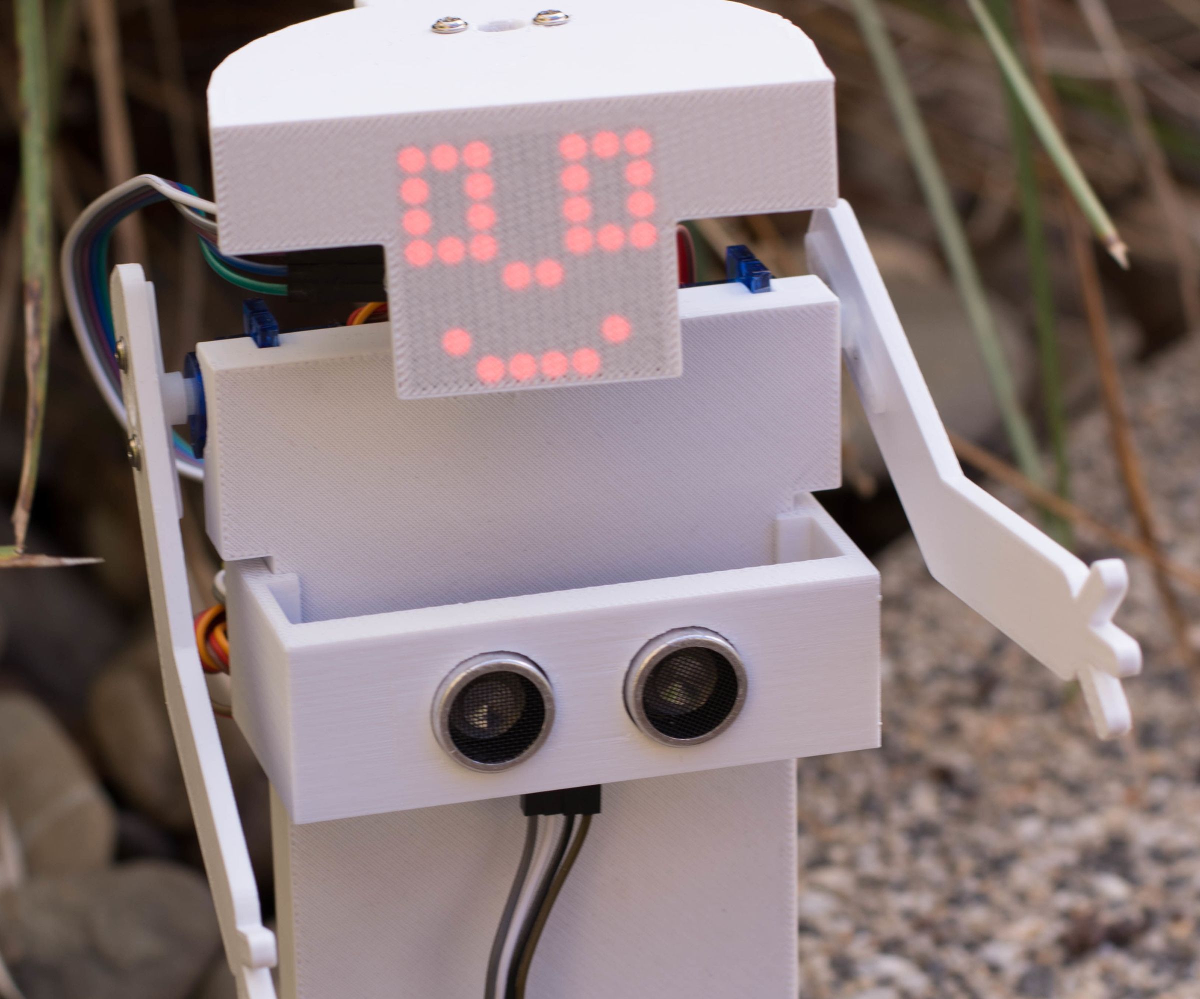

Hey Everyone! Creative Robotix, now that's what we like! Have you ever wanted to imagine, create and make your very own humanoid robot with its very own personality? We have, so we did, and we would like to share with you what we have done.
Our Creative Robotix framework is a skinnable robotic platform that enables you to imagine and create your very own humanoid robot with its very own character. The platform is articulated with 5 low-cost servo motors, enabling differential drive with independent head and arm movements. A set of three bicolour LED’s and speaker allow for designs with colourful facial expressions and a voice to match. The platform also knows where things are, like lines on the floor and if there are obstacles in front in the path of travel. It is powered by an Arduino Nano and has Bluetooth connectivity, which allows you to program the platform to operate in a few different modes. In full autonomous mode the platform makes for a happy little robot independent and carefree, in interactive mode the robot can connect to your mobile phone and you can play with it, or in super smart mode, you can give your robot a 'Brain the Size of a Planet' (as Marvin, the Paranoid Android, a fictional character in The Hitchhiker’s Guide to the Galaxy series by Douglas Adams was said to have) and hook it into the cloud of things via your PC where it can access internet knowledge and talk to other cloud connected Creative Robotix robots out there and share experiences. The options are limitless.
Our design philosophy is based around the 21st Century Robot Project an open source, crowd sourced framework approach to building robots in the 21st Century where robot's are imagined, designed and built to be social, to each have a name, to be community driven, connected, evolving, growing, improving over time, with each contribution and each iteration.

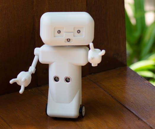

To get you started we’ve included the open source skin, Timmy, which you can customize with your own artistic skills. Timmy, is cute humanoid robot with attitude, he likes reading, drinking coffee, watching ducks fly past while at the park, trying out for the local football team and enjoying a relaxing evening read at home after a busy day
We encourage you to customise Timmy, to give him his own personality, look and style, so why not print him out in white and let your artistic creativity go wild! Alternatively, why not dress him up, and take him out to see a show?
The Creative Robotix base frame is skinnable, so why not show us your design skills and create a new robot character of your own, and perhaps write a creative story about your characters antics using some Science Fiction Prototyping, for more head on over to the Creative Science Foundation. If you are technology minded, then why not try to find new ways to power our platform, perhaps with some of the latest advances in embedded technology, for example CHIP or Pi-Zero and why not try out some other neat sensors, maybe a camera, positioning or even give our platform a sense of smell, or try out adding some other off-the-shelf technology you prefer. By evolving our design, creating your own robots, we hope that you will enter into the spirit of free-sharing by offering your designs back to the community so our Creative Robotix project can fulfill its vision for creating an an open source, crowd sourced approach to building and exploring the future of robotics with Timmy and Friends.
