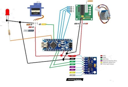

Step 1: Schematic Diagram

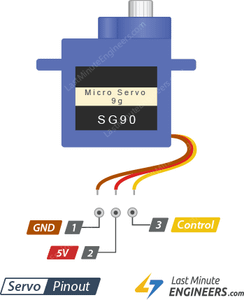

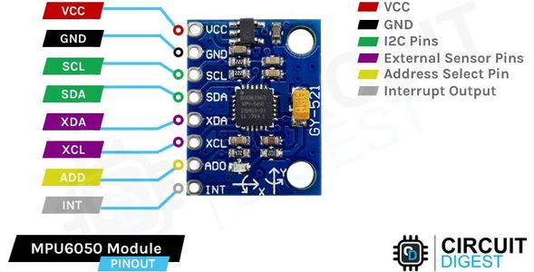

The electrical diagram is shown in the attached image. Accelerometer MPU6050 connects to the SCA, SCL inputs of Arduino boards, pins A4=SDA and A5=SCL. The output for the servomotor is in pin D7. Pins D2, D3, D4, D5, connect to the ULN2003 motor driver. The LED and the resistance of 470 ohms are optional, they indicate the time that the stepper motor is in operation. The command for the LED is in pin D8 of the Arduino board.
