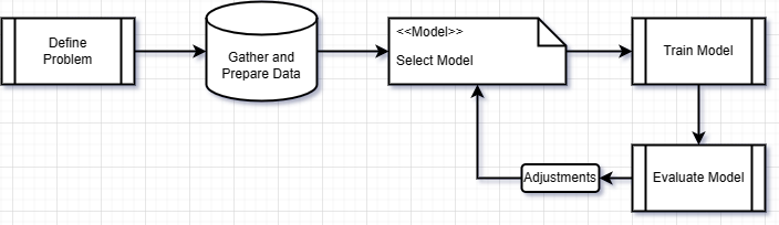

  1. Defining the problem to be solved (in a way that is relevant to machine learning).
  2. Gather and prepare the necessary dataset for solving the problem.
  3. Select and implement an appropriate machine learning model that suites the task.
  4. Train the machine learning model on the training data from the gathered dataset.
  5. Validate the model's performance using the validation data from the gathered dataset.
  6. Fine-tune the model if necessary.

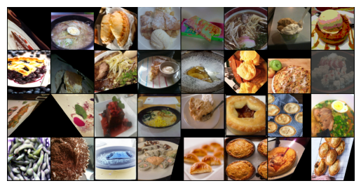

Let's view a sample of our entire dataset by loading a batch from the temporary DataLoader above. We use the imported <make_grid> module from torchvision, and the matplotlib library to display the samples, as written below.
images, labels = next(iter(all_data_loader)) # Load a Batch of Images
grid = make_grid(images[:32], normalize = True) # Create a Grid of 32 Image Samples
plt.imshow(grid.permute(1, 2, 0)) # Display the Images.
# Permute is Done to Make Tensors Viewable as Images
plt.axis('off')
