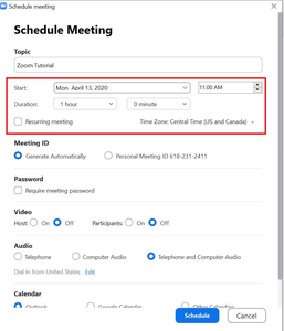

Step 2: Set Up Your Meeting
Go to the Meetings tab and click Schedule Meeting. Select the appropriate date and time of your session and lesson duration. Note, zoom works for intervals of 15 minutes so be sure to keep this in mind. Make sure you’ve chosen the correct time zone as well.

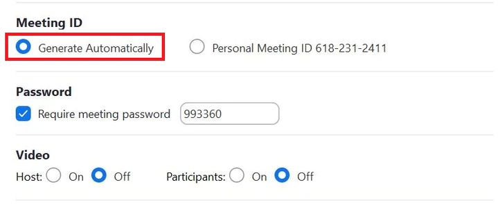

Step 3: Use a Random ID
Random ID's are generated by selecting the 'Generate Automatically' button. Random ID's lower the chance of zoom bombing so refrain from using a personal ID.
Any time a personal ID becomes public, they are susceptible to being zoom bombed multiple times. A personal ID could work well for office hours or any event that occurs frequently throughout the semester. Since this is a never-expiring link, anyone with a hold of it could easily spam your call at any point.
Step 4: Add a Password
Add a Password to the meeting by checking the box right under meeting id's. Users are only able to join if they include submit the correct password prompted by Zoom.

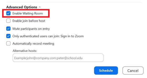

Step 5: Consider a Waiting Room
Check 'Enable Waiting Room' to add the waiting room feature. This feature is way for hosts to manually allow entry into the Zoom meetings. This is a great way to track attendance and cross reference who is a part of the class. You have the ability to confirm everyone at the same time and do it one at a time. Even as the meeting starts, you can continue to have a waiting room and prevent anyone from entering your call in the middle of the meeting. All students who are in the waiting room are located under the "Manage Participants" tab in your zoom call.

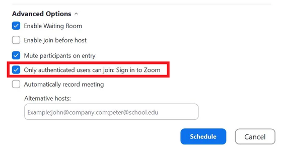

Step 6: Make Your Meeting Invite-Only
As seen in the above image, check mark 'Only authenticated users can join'. This feature highlights a couple of security verification's. You may invite students based on their email. Inform them that they must sign into Zoom using the original email that was sent to them so they may access the meeting. This further excludes anyone who may not have been invited.

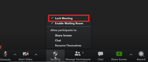

Step 7: Enable Screen Sharing to Host Only
Click on 'Security' and uncheck 'Share Screen' to disable screen sharing for others except the host. You might want to customize your screen sharing options. To do so, click on the arrow next to 'Share Screen' and select 'Advance Sharing Options'. To prevent others from interrupting your planned lecture, ensure that screen share is something that only you as the host can do. These are present features, but make sure they are in place before you allow people to enter the room.

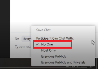

Step 8: Disable Chat
If you plan on using audio to communicate, consider disabling chat or customizing it such that students may only chat with you. Click on the wheel next to the chat window and check mark 'No one' to disable chat.
