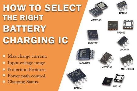

Introduction: How to Select and Use Li-Ion Battery Charging ICs for Your Electronics Projects
In this guide, we'll explore the key factors involved in choosing and using Li-Ion battery charging integrated circuits (ICs) for your electronics projects. Whether you're designing a smartphone, wearable device, or any gadget relying on rechargeable batteries, selecting the right charging IC is crucial for performance and reliability.
Li-Ion Battery Charging ICs (e.g., TP4056, TP4057, TP5100, TP5000, MCP73831, LTC4054, MAX1898, MAX1555, BQ24074, MAX8903)

Step 3: Explore Popular Li-Ion Battery Charging ICs
Let's delve into some widely used Li-Ion battery charging ICs:
  • TP4056: Simple and cost-effective; supports single-cell Li-Ion/Polymer batteries with up to 1A charging current.
  • TP4057: Similar to TP4056 but limited to 500mA charging current.
  • TP5100: Versatile IC supporting single/multi-cell batteries with programmable charging parameters.
  • TP5000: High-efficiency IC with adjustable charging parameters and thermal regulation.
  • MCP73831: Compact IC with low external component count; ideal for space-constrained applications.
  • LTC4054: Features precision voltage regulation and programmable charge current.
  • MAX1898: Multi-chemistry charger with wide input voltage range and exceptional voltage accuracy.
  • MAX1555: Compact IC with integrated safety features for small-sized batteries.
  • BQ24074: Versatile IC supporting USB OTG functionality and up to 1.5A charging current.
  • MAX8903: Dual-input charger with high-speed switching and smart power control.
