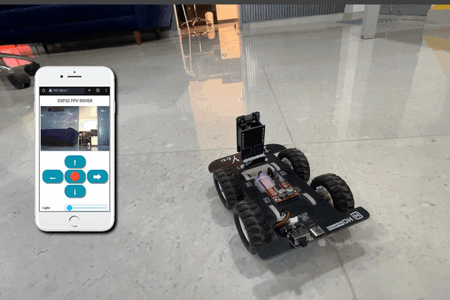

Step 5: Programming and Assembling the ESP32
Install the ESP32 core for the Arduino IDE and required libraries (AsyncTCP and ESPAsyncWebserver). Upload the provided Arduino code to the ESP32 module. The code handles web controls and the video stream, allowing remote operation of the car.
After PCB assembly, attach all other required components such as motors, wheels, and battery to the PCB. Secure motors and battery using provided mounting holes and cable ties.
Step 6: Testing and Operation
Once assembled, power on the ESP32 Cam Surveillance Car. It will create a WiFi access point (SSID: circuitdigest, Password: circuitdigest). Connect your smartphone to this network and open a browser to navigate to 192.168.4.1. Here, you can view the live video stream and control the car's movement using the on-screen buttons.
