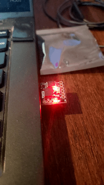

Step 9: Select Proper Board Type
here, Selecting the Proper Code is the deal breaker of this entire Setup. to do so,
we will
  1. select “Digispark (Deafult-16.5Mhz)” from Board Menu in Tools.
  2. select programmer as “Micronucleus" from Board Menu in Tools.
Step 10: Upload the Code
normally we would compile and Upload the code with our Arduino Connected, but here in Attiny85, we will
  1. Compile the code
  2. Press UPLOAD button
  3. wait for Plug in device now... (will timeout in 60 seconds) this message.
  4. Connect the Board Within 60 Seconds .
  5. wait for "Micronucleus done. Thank you!" Message From compiler.
  6. Enjoy!
Ouput of this code will show blinking LED on Pin 1 on the Board
