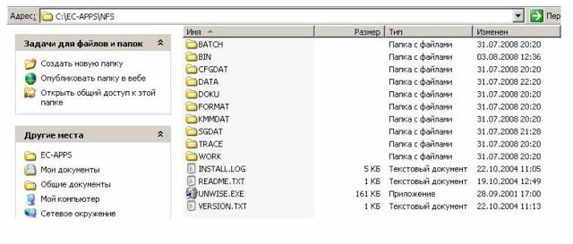

1.Install WinKFP
2.After installation we get some directories
After installation the directory (Drive letter):\EC-APPS\NFS\SGDAT
contains file CABI.h only, and doesn’t contains files, required for working.

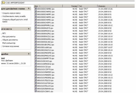

4.Now copy all *.IPO files from every directory (Drive letter):\SP-daten-Exx\sgdat to
directory (Drive letter):\EC-APPS\NFS\SGDAT. For this purpose better use Total
Commander, it allows to overwrite elder files with newest.
This directory now looks like this:
