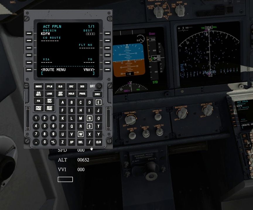

Step 1: Program the FMC With Your Flight Plan
To get the ILS frequency, you need to have your flight plan set all the way up to your approach runway. you don't need the VNAV set but you do need the LNAV. if you don't know how to program your FMC with waypoints and arrival runways check my other Instructable; How to Program X-Plane 11 Default 737 FMC .Or if you already know your runway's ILS frequency and CRS, then you can skip to step 5.
