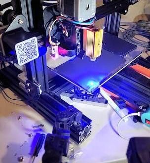

I recently upgraded my Ender 3 Pro with an SKR 2 controller. I loved the extra controllable fan ports. Went from always on hotend fan and switching the controllable port from fan to laser, to controlling all 3 independently. Only non-controllable fan left was the controller case fan and I couldn't let that stand.

PE6 is the pin for the RGB port on the SKR2. I assume the same could be done with any boards with an RGB port. You will just need to use the correct pin assignment. This was honestly easier than I expected, although I did have some confusion around the M710 command and manually setting the speed. Marlin documentation says the command M710 A0 S255 should turn the fan on right away. I was not able to get this to work. What did work for my testing was setting the controller fan idle speed, M710 A0 I255. Just make sure to set it back to auto when done testing: M710 A1
