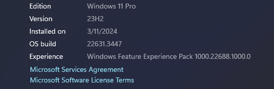

Step 2: Verify Windows Verson
Local group policy editor is not included with Windows 10 or 11 Home. You need pro or above to use it. To check your edition, go to settings, select system from the left menu, and scroll down to about at the bottom of the list. then check your edition as shown in the photo above. If it is Windows 10 or 11 Home, then upgrade to pro, or to get it for free, see my instructible on it.

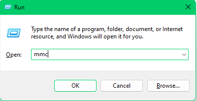

Step 4: Make Group Policy for Other Users
To make a group policy for a different user, press 🪟key + R. A box will open, then type "mmc" in the box, and press enter. A box will come up asking you if you want mmc to make changes to your device. Click yes, and the in the new windows, click on file > add and remove snap in's. In the window that opens, click on group policy on the left, and then click add. In the box that opens, click browse, and then click users at the top. select the option from the list, and then click finish. close the app, and when asked to save, navigate to a location you like.
