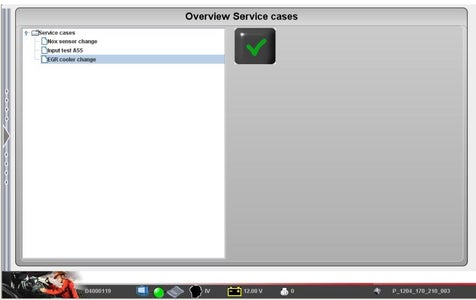

If you want to do initialization the Service Case EGR cooler exchange must be performed after the EGR cooler exchange by SERDIA2010.
Handling in service in the case of an exchange of the EGR cooler to the engine of the BR 2.9 and 3.6 T4i DOConly.
Deutz Decom Communicator
Step 1:

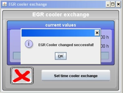

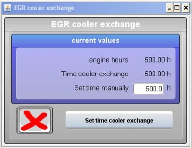

Step 2:
Press “Set time cooler exchange” button
Step 3:
Current operating hours are taken and written as the date of the cooler exchange into the control
unit
Step 4:
Operation completed
