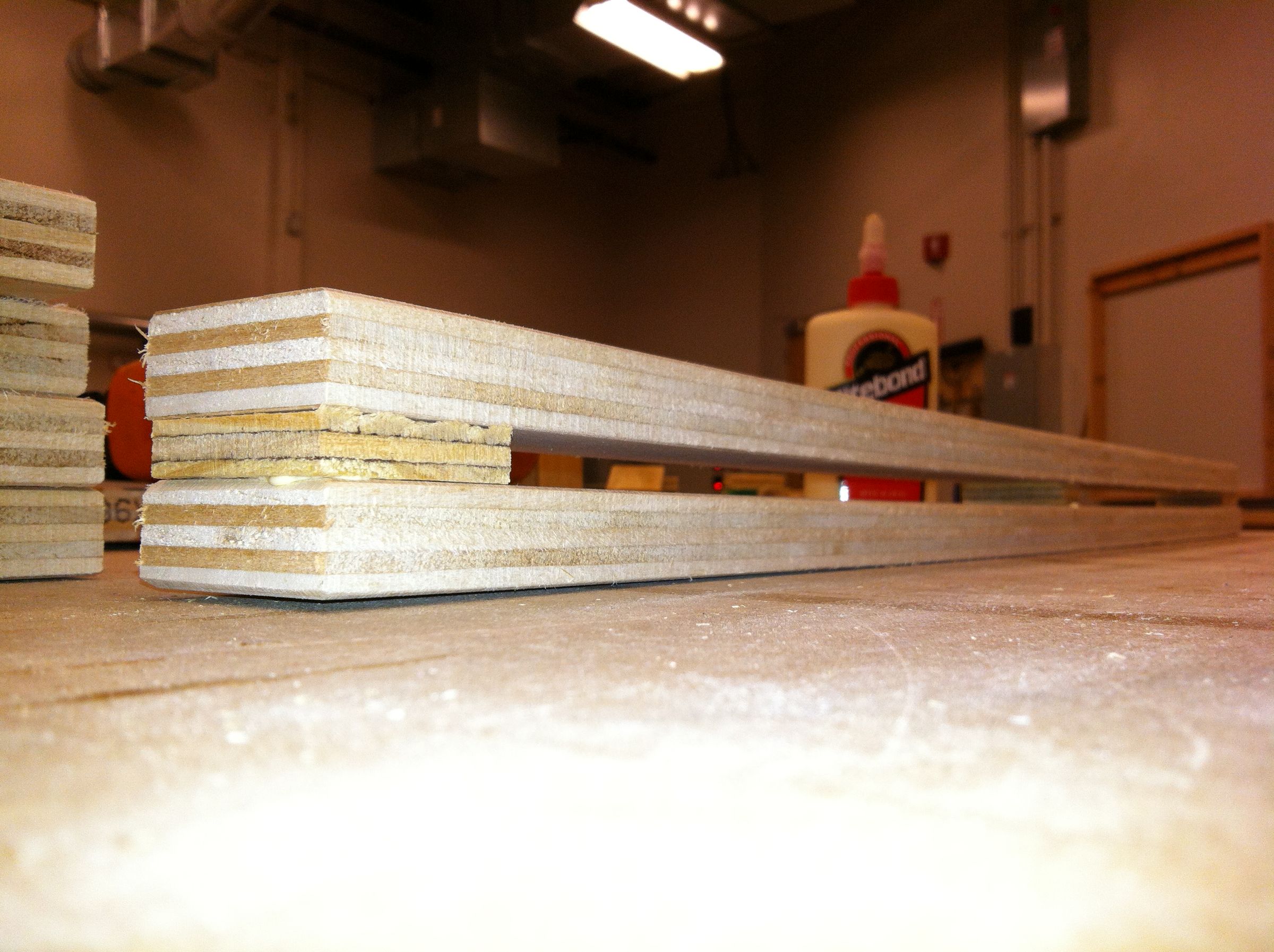

Step two: After you have created a pattern to cast, you will need a flask. This is a box or some sort of receptacle that your pattern can fit inside with at least 2 or 3 inches of spacing between the pattern and the top, bottom and sides of your flask. I used scrap plywood that I glued and nailed together. You can use just about anything that has rigidity or wont flex or bend as you pack sand into it. Try concrete cylinder forms or a metal pale in place of building a wood box.
