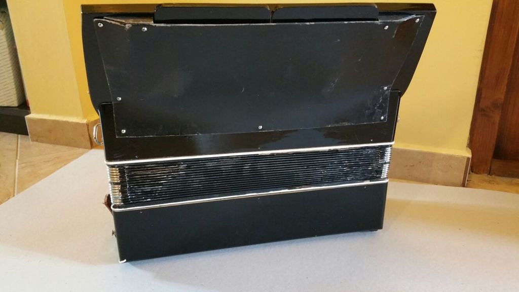

As much fun as accordions are, they can be quite intimidating to take apart, clean, or fix. There are very few accordion builders and very few accordion restorers as well- professional or amateur. Most accordions are antiques, which means that most accordions are in some state of disrepair. The most common problem with accordion keyboards is that they are dirty, and contain oxide and/or gunk thats gumming them up. This can be obvious, as when a key stays depressed when pushed, or subtle, like some keys might have a slightly delayed response that can be hard to recognize if you haven't played a recently cleaned accordion. There can be other probems with keys, however, which I try to get at in step #7.

Step 2: Removing the Faceplate/ Grill
This Accordion's grill has 7 screws. I have an accordion that has only 2 screws, and one that shoud use 4 screws (but uses duct tape instead because I lost all the screws travelling. Don't let it happen to you, it sucks) so your's is probably different
Also +100 Meticulous Accordion Fanatic Points if you can put each screw back in the same hole when you're done!
Once all the screws are unscrewed, CAREFULLY lift the plate off. Some of them are stubborn, so be patient. Also pay close attention to how the register switches relate to the grill. Remember to breathe, and set the grill somewhere safe to the side.
