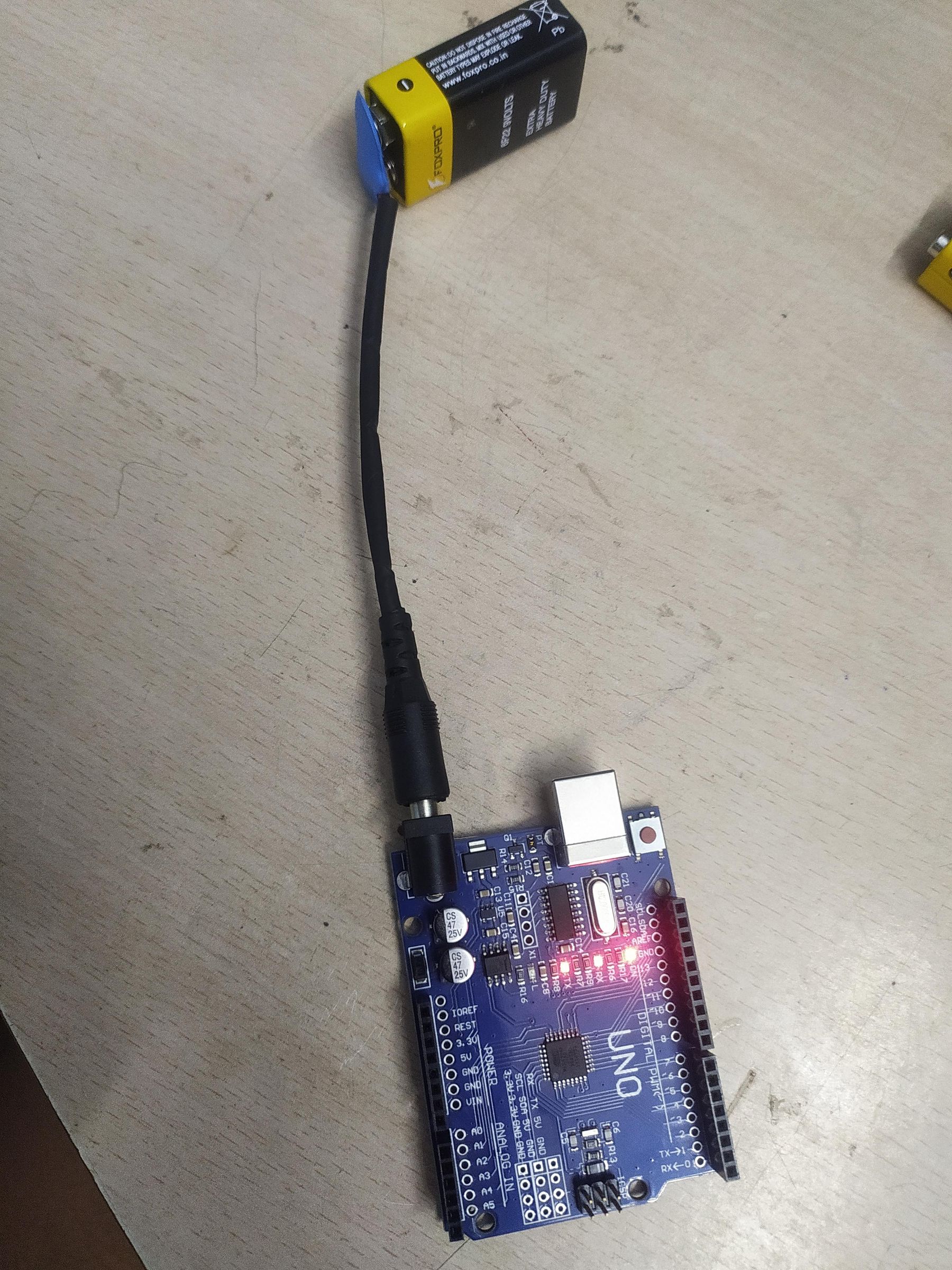

Step 1: Genuine Arduino and Chinese Clone - the CH340 Chip Problem
I use an Arduino Uno for this example but it is the same process for most Arduino models.
So here we have a genuine Arduino and a Chinese clone. Let's do the test.
My Arduino environment has been installed and is working properly. First I plug in the genuine Arduino. Everything works just fine. Now I use my cheap Chinese copy and.... the computer does not recognise the hardware.
The problem is that the clone does not use the standard serial to usb chip but a chip marked CH340. Your computer will not recognize these CH340 chips on your computer. To fix this is very easy.
