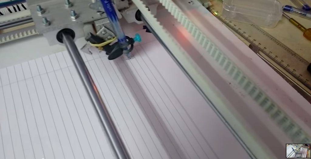

Introduction
Last month, I made a XY-plotter by Makeblock and use it to built a Drawing Robot.
This Drawing Robot was built with two Linear Motion Shaft D8x480mm, two Long Beam0824, the timing belt, two stepper motors, two stepper motor driver, and a micro-controller Arduino. You can send a picture from the phone or you can take a picture by the phone and then send it to the robot by Bluetooth. After that the robot will draw what you send.
BUY NOW
The instruction will show you how to build a XY-plotter.
For the program process, please visit the user guide. It contains both the turtorials of how to use Android app to control XY-plotter, and how to use Gcode to control XY-plotter.
If you have any question about it, pleas visit the troubleshooting of XY-plotter to help yourself. Or you can just post your question on the forum, I will give a response in minutes.

Step 18: XY-Plotter Application for Android
See more details about the codes and app for Android here. It would tell you how to run the XY-plotter by Android app.
That's all. Have fun!
