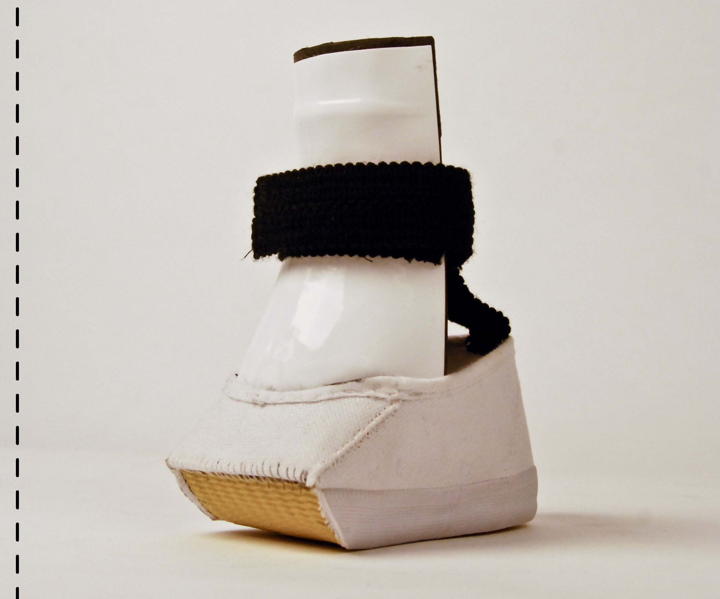

Step 5: Connecting the Slippers and the Instep
  1. Put the instep back on the first line and fix its position using paper tape.
  2. Glue the bottom of the instep on the sole of the slipper using a flexible filling glue. We used Tec7 but others are possible.
  3. Allow to dry for 24h.
  4. Bend the front part of the sole as much as you can and fix its position too, using paper tape.
  5. Fill the space between the bended sole and the instep with Tec7.
  6. Allow to dry for 24h.
  7. Repeat 1 to 6 for the other slipper and instep if necessary.
Step 6: Stitching the Shoe Tip
  1. Stitch the left over canvas to the bent sole. This is a difficult task because of the hardness of the sole and the stitching angle. We recommend to us a moon shaped needle or to make this needle yourself. Hardened needles will break when you try to bend them but sheap, not hardened needles bend easily. Using a small pliers can be useful to pull the needle trough the sole.
  2. Cut away the unused canvas at the end of the seam.
  3. Sew the two parts of canvas to each other at the corner of the tip.
  4. Glue the bent sole to the rubbery sole sides of the slippers. Use a universal glue.
  5. Finish the canvas parts by adding a white border.
  6. Repeat 1 to 5 for the other slipper if necessary.
Step 7: Adding a Velcro Lace
  1. Measure the circumference of the clients ankle.
  2. Cut off a strap at this length.
  3. Sew 8 cm of the loop part of a Velcro at one end of the strap and 5 cm of the hook part on the opposite side of the strap (the other end but this time on the back side).
  4. When using a knitted strap, you could also add a soft textile band in the middle to avoid extensibility of the final lace.
  5. Cut off a second strap to make a connection between the Velcro lace and the shoe.
  6. Use the second strap to make a loop at the heel of the shoe.
  7. Repeat 1 to 6 for the other lace for the other shoe if necessary.
