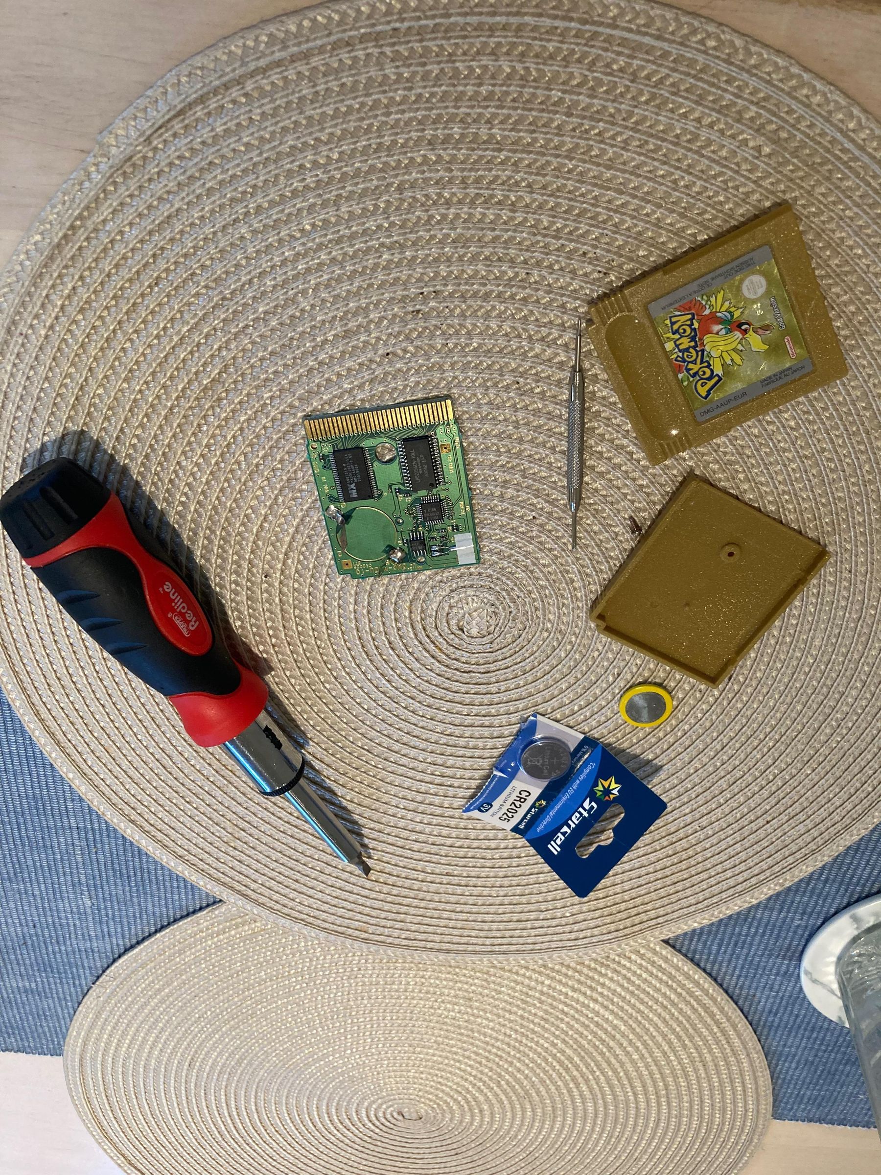

You will need:
A small straight head precision screwdriver,
A CR2025 battery, I'm sure other similar batteries e.g. CR2032 etc. will work but on the pcb it says CR2025 so thats what I used.
And
Some sticky tape,
You can also buy special batteries from the internet, which have tabs to solder directly to the pcb which will created the most secure connection possible, however if you tape the battery firmly then it should be just as good.
Step 2: Open It Up!
Turn the screw on the back anticlockwise until it comes out. Ideally you would use a smaller screwdriver than I used but thats what I had to hand.
Step 3: Take Off the Old Battery and Put the New One On
I did this a while ago so you can see the battery already replaced but you can get the idea.
Take the precision screwdriver and push it from where the tab is stuck onto the battery near the outside in towards the inside therefore removing the tab from the battery but keeping it attached to the pcb. Repeat on the tab stuck to the bottom of the battery.
Stick on the new battery with the tape making sure to get good contact between the battery with the tabs. If that comes loose then your save gets deleted :-(
Note that the battery goes in upside down (see the polarity markings on the pcb)
Please do not solder the tabs onto the battery as this is very dangerous and could cause the battery to explode
Step 4: Your Done!

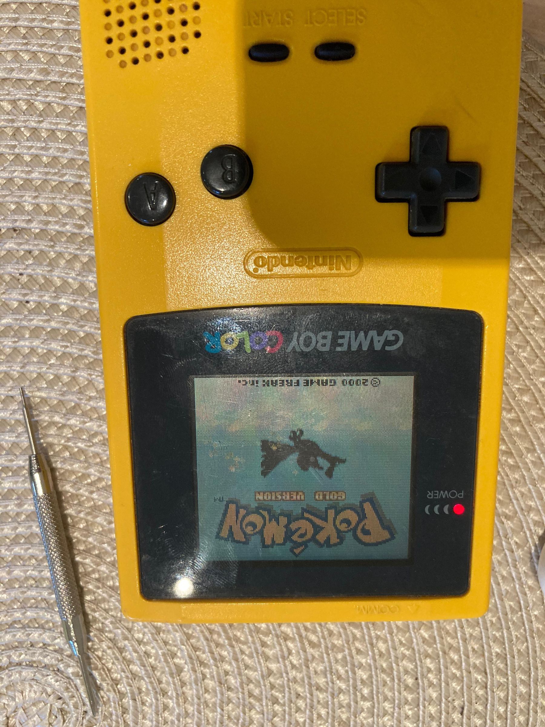

Put it back together by repeating step 2 (except clockwise). Then put it in your gameboy and turn it on. Start a new game walk outside and save then turn off. Wait about 15 seconds, turn on and if your save is still there it worked.
