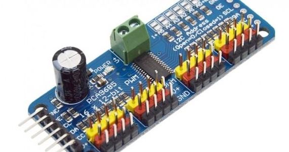

- PCA 9685

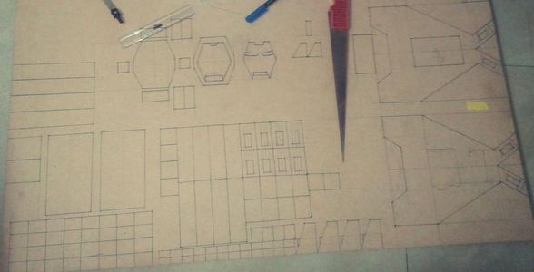

Step 2: Getting Parts to Cut
*Above images are of the first prototype, significant changes were made after that*

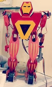

Step 4: Final Prototype
Legs were redesigned and feet remained the same.
knee Joints were removed and the whole leg was made in one piece.
Now the robot can remain standing

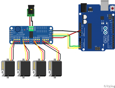

Step 5: Circuit
Reference:
https://forum.arduino.cc/t/pca9685-driver-and-simultaneous-servo-motors-issues/623755 (PCA9685)
https://www.vegoilguy.co.uk/reverse_polarity_switching.php (Wiring and Using DPDT switch)
Step 6: Code
*Add the required library from link given below*
Attaching all servo's horns after putting them in ideal condition.
Now you can make ur hand moments by adding steps and defining the position.
Reference:
https://github.com/adafruit/Adafruit-PWM-Servo-Driver-Library
