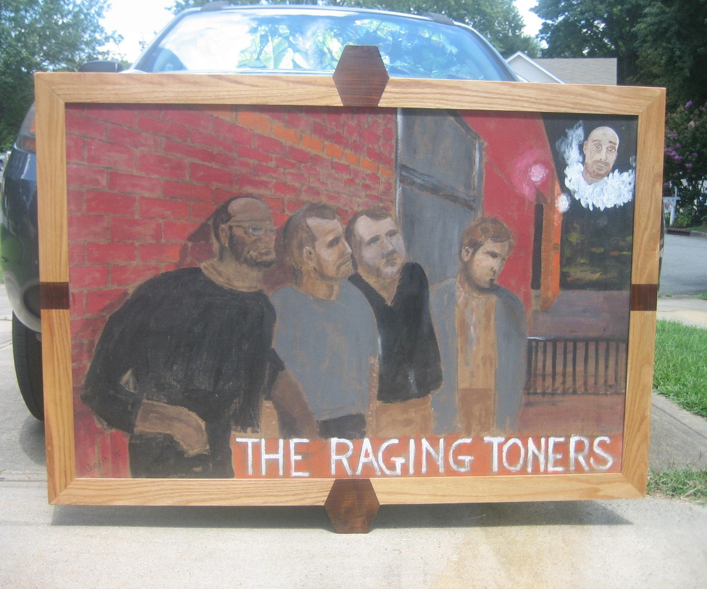

These pictures show all the parts to create this jig. I made this for the Shadow Box Bookcase I built. This jig was made for a specific router and for routing into boards up to 12" wide and determine the final dimensions shown in the last picture. Yours will probably be different if you make one.

The only other thing you must take into consideration is the depth of the dado. You should add this depth times two (one for each side) to the length of the shelf you are installing. If you look at the intricacies of this shadow box bookcase I built you can see how an error can magnify itself by the time you're done.
