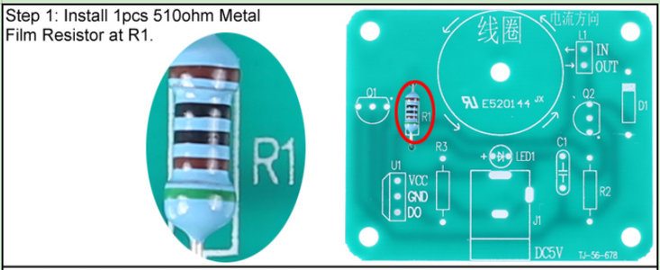

Step 1: Install 1pcs 510ohm Metal Film Resistor at R1
Install 1pcs 510ohm Metal Film Resistor At R1

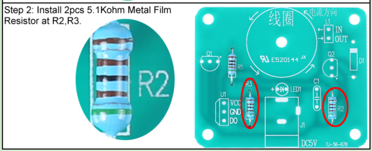

Step 2: Install 2pcs 5.1Kohm Metal Film Resistor at R2,R3

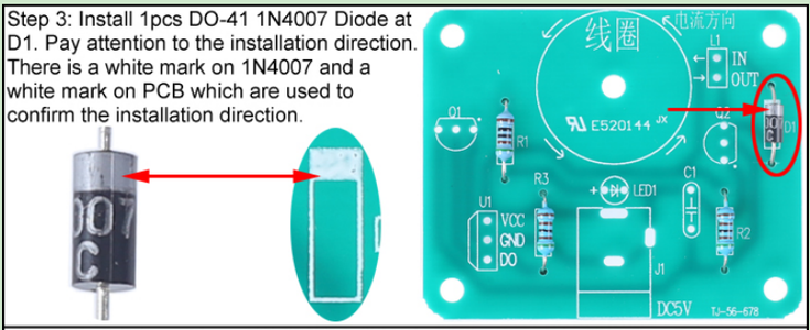

Step 3: Install 1pcs DO-41 1N4007 Diode at D1
Pay attention to the installation direction. There is a white mark on 1N4007 and a white mark on PCB which are used to confirm the installation direction.

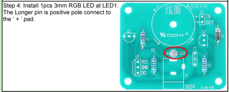

Step 4: Install 1pcs 3mm RGB LED at LED1
The Longer pin is positive pole connect to the '+' pad.

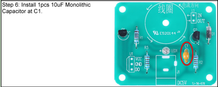

Step 6: Install 1pcs 10uF Monolithic Capacitor at C1

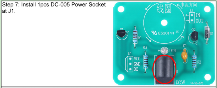

Step 7: Install 1pcs DC-005 Power Socket at J1

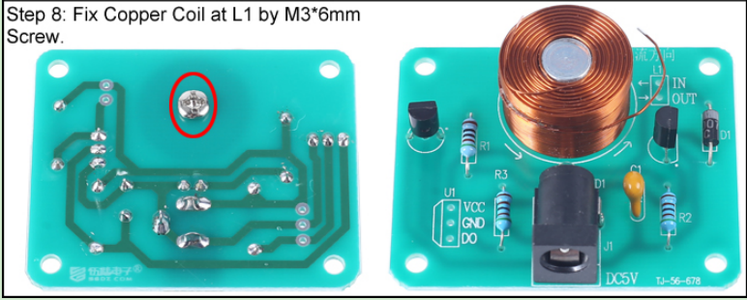

Step 8: Fix Copper Coil at L1 by M3*6mm Screw

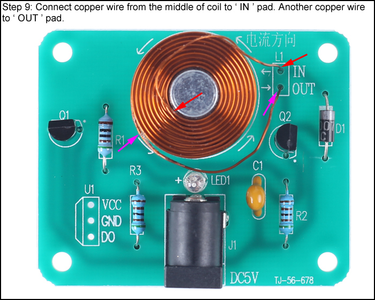

Step 9: Connect Copper Wire
Connect copper wire from the middle of coil to 'IN' pad. Another copper wire to 'OUT' pad.

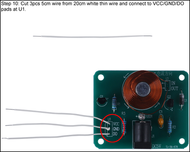

Step 10: Cut 5cm Wire
Cut 3pcs 5cm wire from 20cm white thin wire and connect to VCC/GND/DO pads at U1.

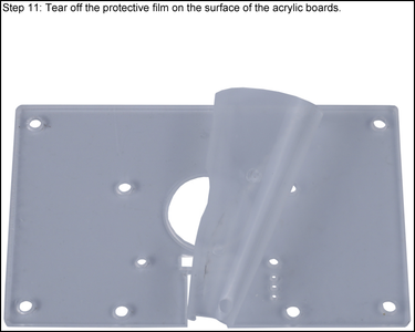

Step 11: Tear Off the Protective Film

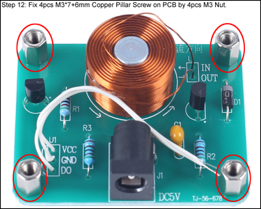

Step 12: Fix 4pcs M3*7+6mm Copper Pillar Screw

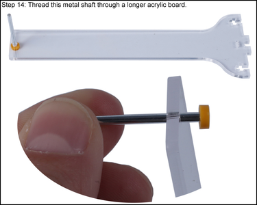

Step 14: Thread This Metal Shaft Through a Longer Acrylic Board

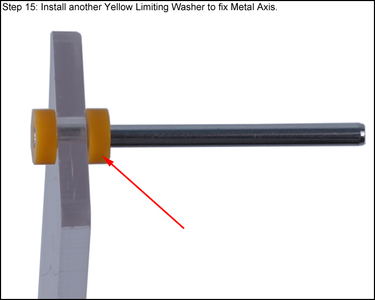

Step 15: Install Another Yellow Limiting Washer to Fix Metal Axis

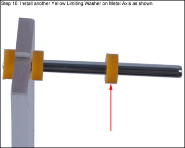

Step 16: Install Another Yellow Limiting Washer on Metal Axis

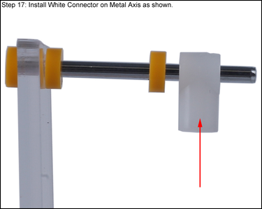

Step 17: Install White Connector on Metal Axis

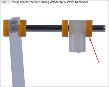

Step 18: Install Another Yellow Limiting Washer to Fix White Connector

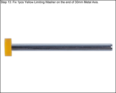

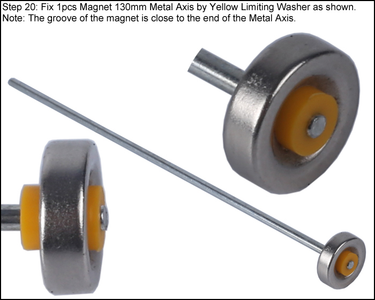

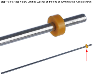

Step 19: Fix 1pcs Yellow Limiting Washer on the End of 130mm Metal Axis
Step 20: Fix 1pcs Magnet 130mm Metal Axis by Yellow Limiting Washer
Note: The groove of the magnet is close to the end of the Metal Axis.

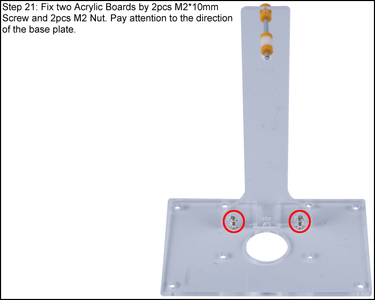

Step 21: Fix Two Acrylic Boards
Fix two Acrylic Boards by 2pcs M2*10mm Screw and 2pcs M2 Nut. Pay attention to the direction of the base plate.

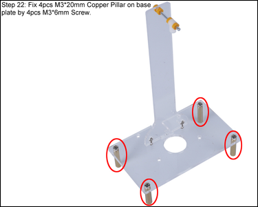

Step 22: Fix 4pcs M3*20mm Copper Pillar on Base Plate

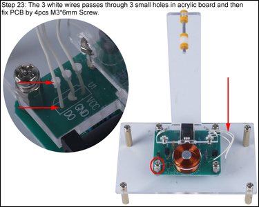

Step 23: Fix PCB by 4pcs M3*6mm Screw

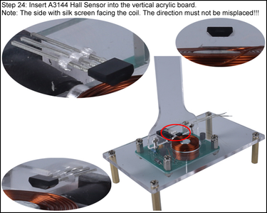

Step 24: Insert A3144 Hall Sensor Into the Vertical Acrylic Board.
Note: The side with silk screen facing the coil. The direction must not be misplaced!!!

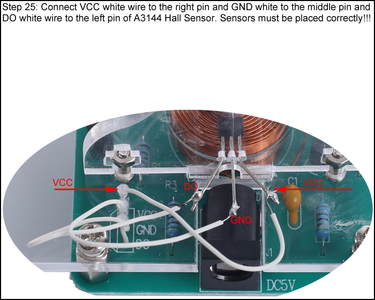

Step 25: Connect VCC and GND White Wire
Connect VCC white wire to the right pin and GND white to the middle pin and DO white wire to the left pin of A3144 Hall Sensor. Sensors must be placed correctly!

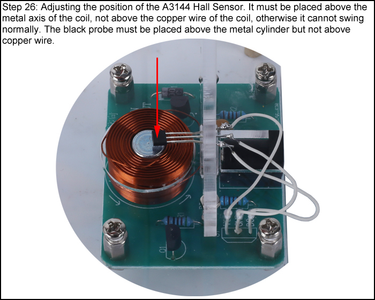

Step 26: Adjusting the Position of A3144 Hall Sensor
It must be placed above the metal axis of the coil, not above the copper wire of the coil, otherwise it cannot swing normally. The black probe must be placed above the metal cylinder but not above copper wire.
