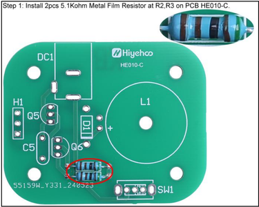

Step 1: Install 2pcs 5.1Kohm Metal Film Resistor at R2,R3 on PCB HE010-C.

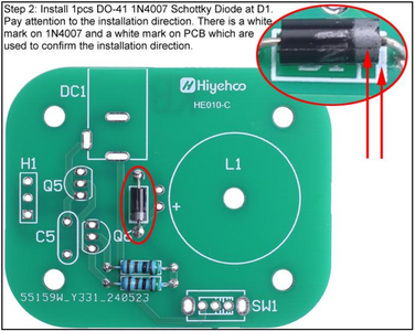

Step 2: Install 1pcs DO-41 1N4007 Schottky Diode at D1
Pay attention to the installation direction. There is a white mark on 1N4007 and a white mark on PCB which are used to confirm the installation direction.

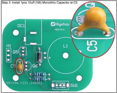

Step 3: Install 1pcs 10uF(106) Monolithic Capacitor at C5

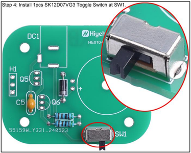

Step 4: Install 1pcs SK12D07VG3 Toggle Switch at SW1

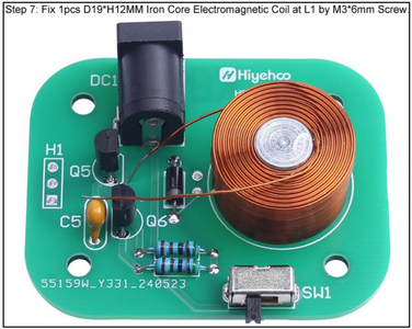

Step 7: Fix 1pcs D19*H12MM Iron Core Electromagnetic Coil at L1 by M3*6mm Screw

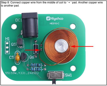

Step 8: Connect Copper Wire From the Middle of Coil to ‘ + ’ Pad.
Another copper wire to another pad.

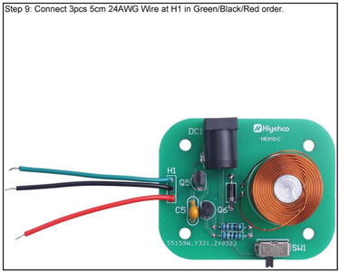

Step 9: Connect 3pcs 5cm 24AWG Wire at H1 in Green/Black/Red Order.

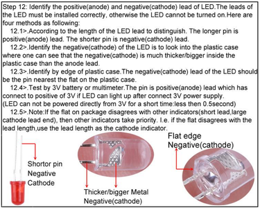

Step 12: Identify the Positive(anode) and Negative(cathode) Lead of LED.
The leads of the LED must be installed correctly, otherwise the LED cannot be turned on.Here are four methods as following:
12.1>.According to the length of the LED lead to distinguish. The longer pin is positive(anode) lead. The shorter pin is negative(cathode) lead.
12.2>.Identify the negative(cathode) of the LED is to look into the plastic case where one can see that the negative(cathode) is much thicker/bigger inside the plastic case than the anode lead.
12.3>.Identify by edge of plastic case.The negative(cathode) lead of the LED should be the pin nearest the flat on the plastic case.
12.4>.Test by 3V battery or multimeter.The pin is positive(anode) lead which has connect to the positive of 3V if LED can light up after connect 3V power supply.(LED should not be powered directly from the 3V for a short time:less then 0.5second)
12.5>.It is positive(anode) where the white mark “+” pointing to on PCB.

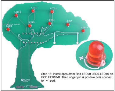

Step 13: Install 8pcs 3mm Red LED at LED9-LED16 on PCB HE010-
The Longer pin is positive pole connect to ‘ + ’ pad.

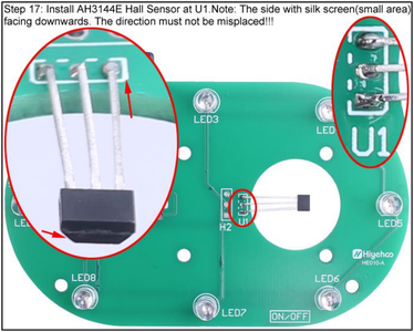

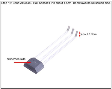

Step 16: Bend AH3144E Hall Sensor’s Pin About 1.5cm.
Step 17: Install AH3144E Hall Sensor at U1
Note: The side with silk screen(small area) facing downwards. The direction must not be misplaced

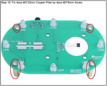

Step 18: Fix 4pcs M3*20mm Copper Pillar by 4pcs M3*6mm Screw.

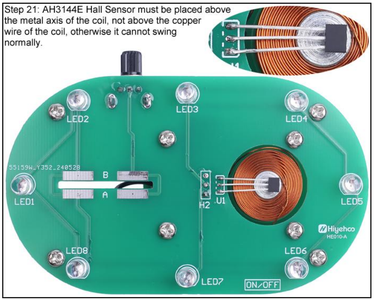

Step 21: AH3144E Hall Sensor Must Be Placed Above the Metal Axis of the Coil

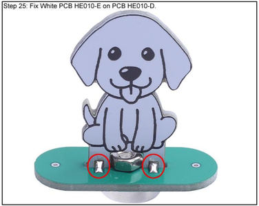

Step 25: Fix White PCB HE010-E on PCB HE010-D.

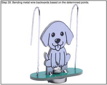

Step 26: Straighten and Cut 2pcs About 8cm Metal Wire From D0.7*200mm Metal Wire.
Step 27: Align HE010-E’s Horizontal Position
Step 28: Bending Metal Wire Backwards Based on the Determined Points.
Step 29: Pass the Metal Wire Through the Installation Hole on PCB HE010-B.
Step 30: Done!
