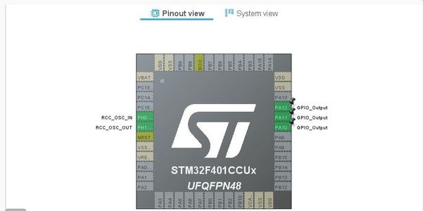

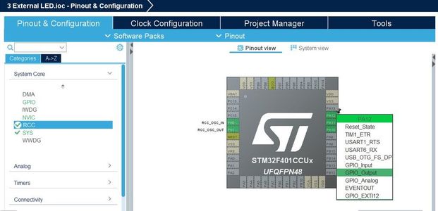

Step 2: PINOUT Configuration
  • Select RCC from System Core.
  • Select the Cereamic/crystal response in High speed clock.
  • Some configurations wlll be added ,i.e,RCC_OSC_IN & RCC_OSC_OUT ON STM32 board of cubeide.
  • Select the Pins for output .(here I used PA10,PA11,PA12).

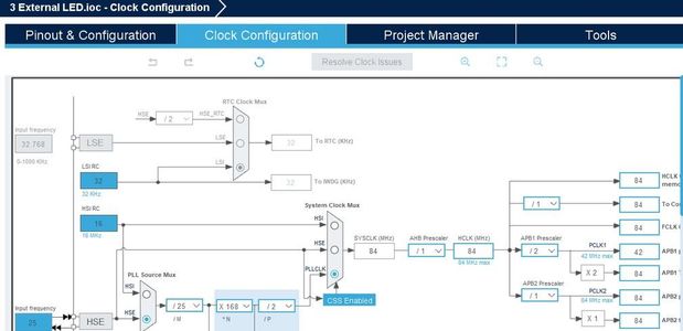

Step 3: CLOCK CONFIGURATION
  • Select clock configuration.
  • Select HSE and PLLCLK in PLL Source MUX & System Clock MUX respectively.
  • Then select resolve clock issues
