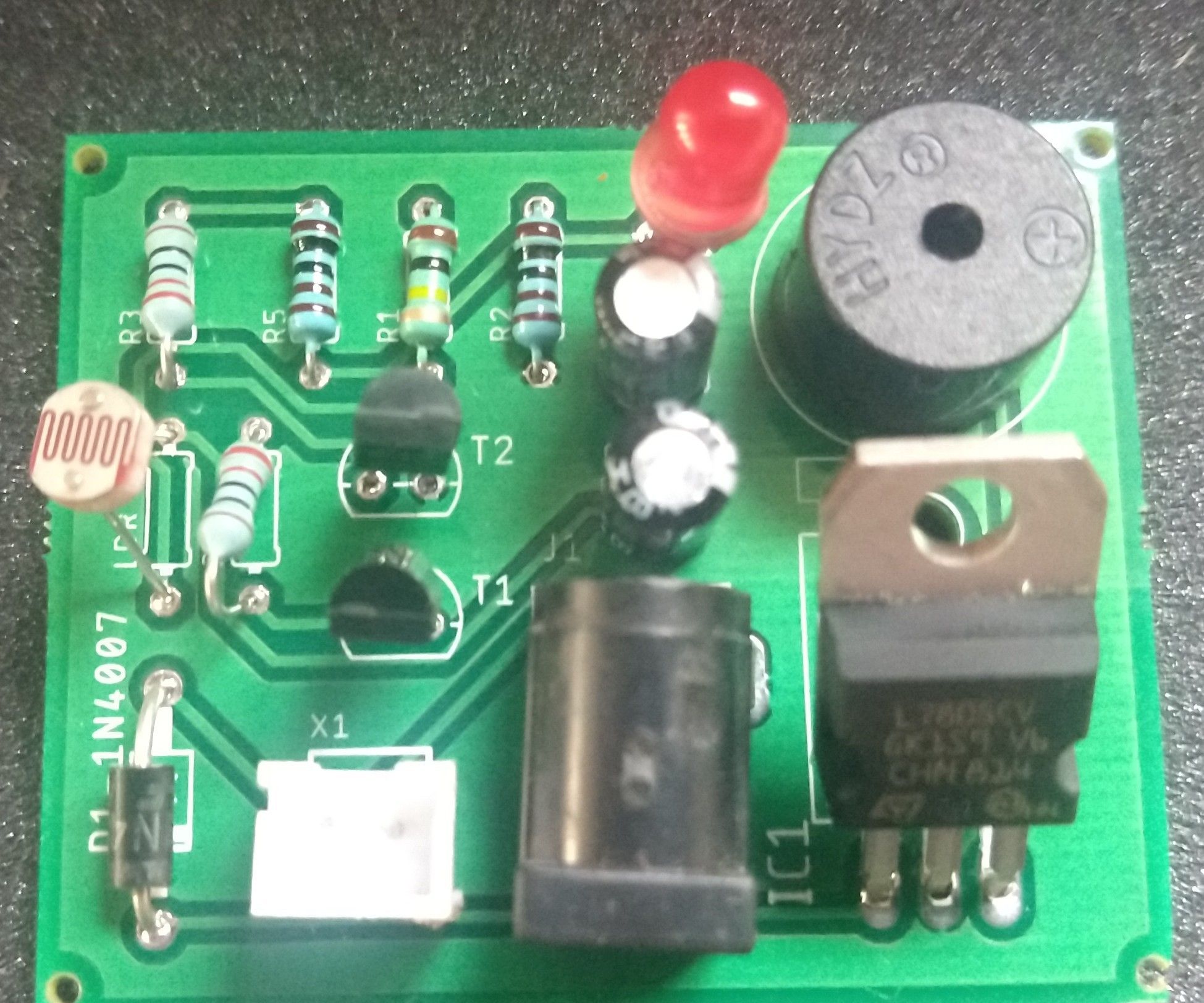

Step 2: Components Assembled Board
The above figure shows all components are assembled on the PCB Board. I have used a 12 v adapter for input supply, All the future discussion of IR Illuminators refers only to active IR Sources, unless otherwise specified. So, coming to the uses of IR Illuminators, one of the main applications of Night Vision Technology. Usually, they are fitted around the camera lens so that the camera captures the objects as they reflect the IR Radiation emitted by the IR Illuminators. If your home or office has CCTV Cameras for security purposes, then chances are that is definitely has an integrated IR Illuminator in the form of an array of IR LEDs.
