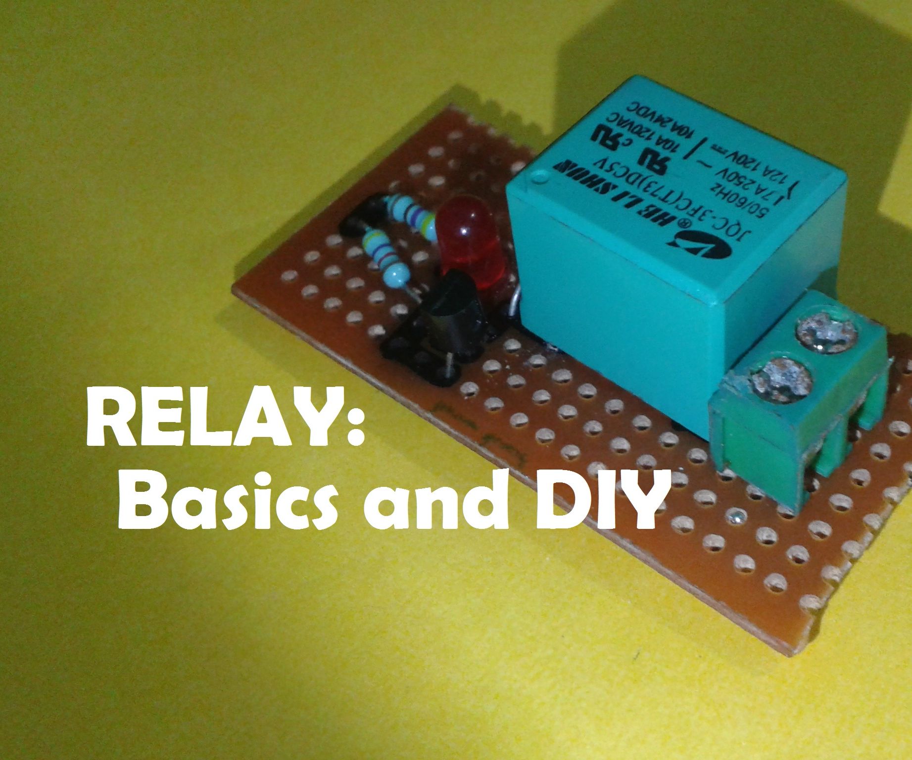

Step 7: Make the Relay
You can buy a relay board (here) or make one yourself following these simple steps:
To do this circuit on the board, we need to:
- Cut a piece of perf board.Mark on the board as shown in the picturesSolder the 470 ohms resistor as shown and the LED.
- Solder the 547 transistor.
- Solder the 4.7 Kohms resistor with one led to the input end and the other to the middle pin of the transistor.
- Solder the relay. Connect one end of the coil to the collector pin of the 547 transistor and leave the other end free.
- Solder the diode across the relay as shown.
- Solder a 2 pin terminal connector near the relay.
- Now joint the resistor ends for the input signal.
- Joint the negative pin of the LED and emitter pin of the transistor.
- Connect the common pin and the NO pins of the relay to the terminal connector.
- Now we have to take 3 wires out.
- Solder a red wire to the one end of the relay coil (the one we left). This is the Vcc.
- Solder a black wire to the point where emitter pin of the transistor and negative of the led meets. This is the Ground.
- Solder one more wire to the point where both the resistors meet (the signal wire).
- Strictly follow the steps and the pictures attached.
