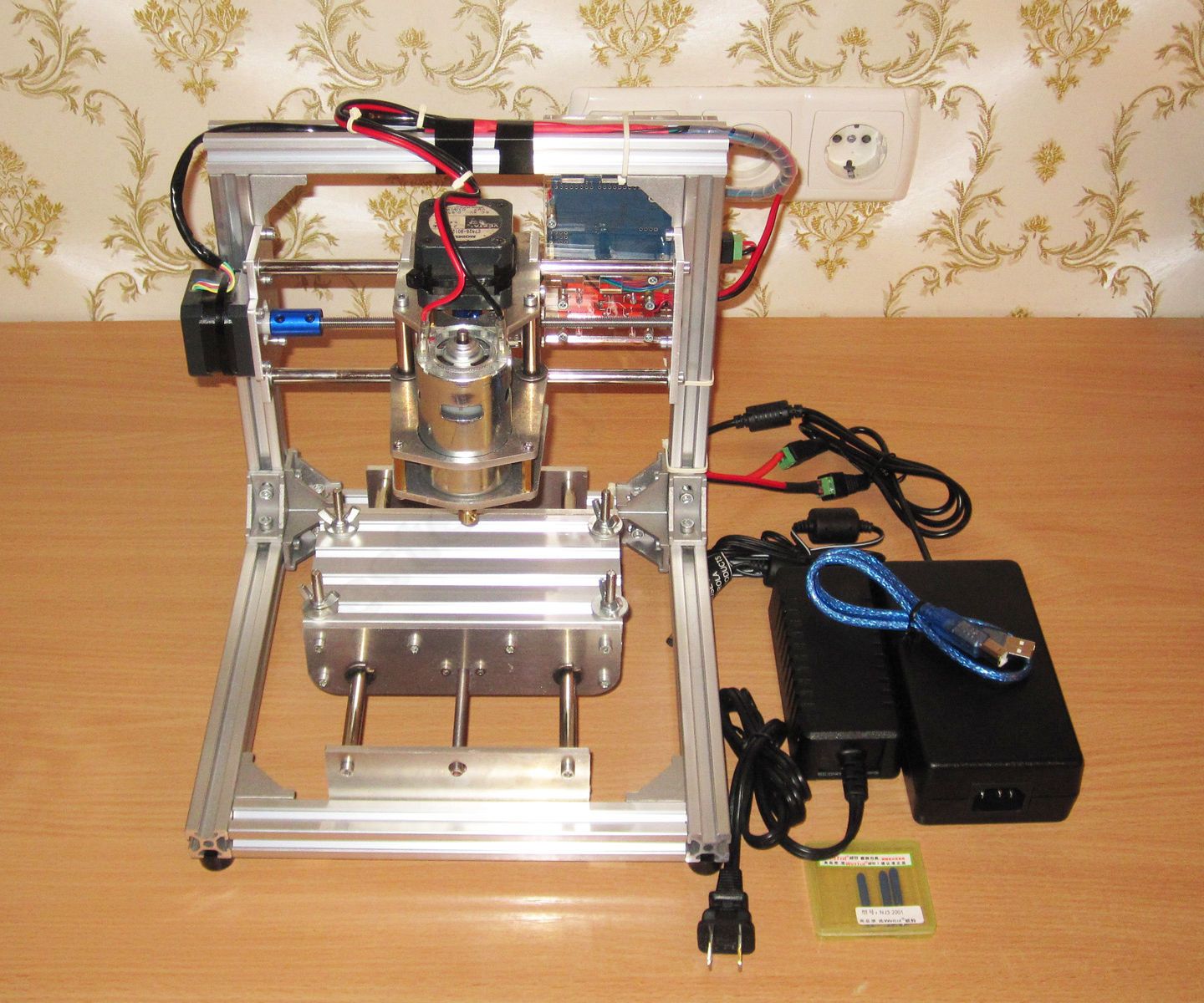

Not long ago I was talking about buying and assembling a small engraver.
But he had some problems that I wanted to fix.
And today I want to tell you about how I finished this engraver and what I used for this.
Reference to the first part of the review - Link

Step 15: Improvement of the Machine
All three sets as they will be installed on the machine.
Now you can proceed to the improvement process.
Step 16: Improvement of the Machine Part 2
First I took off the shaft that moves the table. The photo shows what was and what is planned to be delivered.
Also a comparative photo of old and new couplings.
