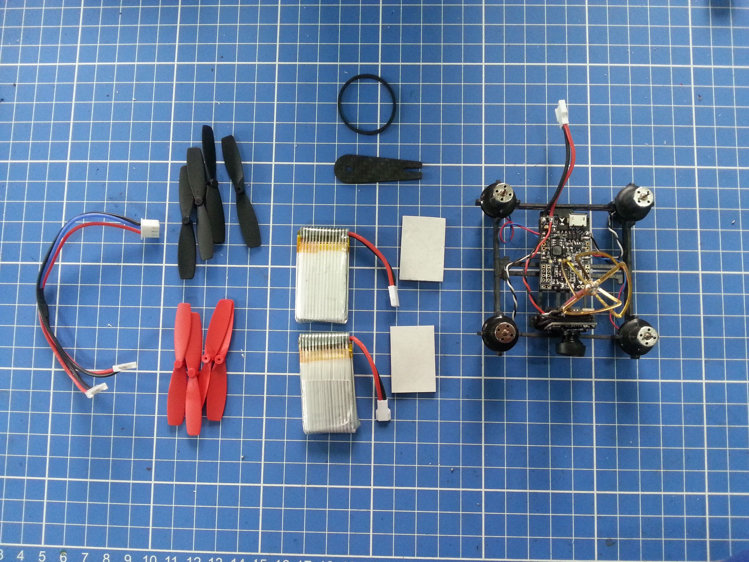

Package Contents:
1 x QX80 Miicro Quad
2x sets Propeller,
2x 3.7V 600mAh Battery
1x 2s Charging plug [Balancer]
2x Foam Adhesive tape
1x Prop removing tool
1x Rubber band

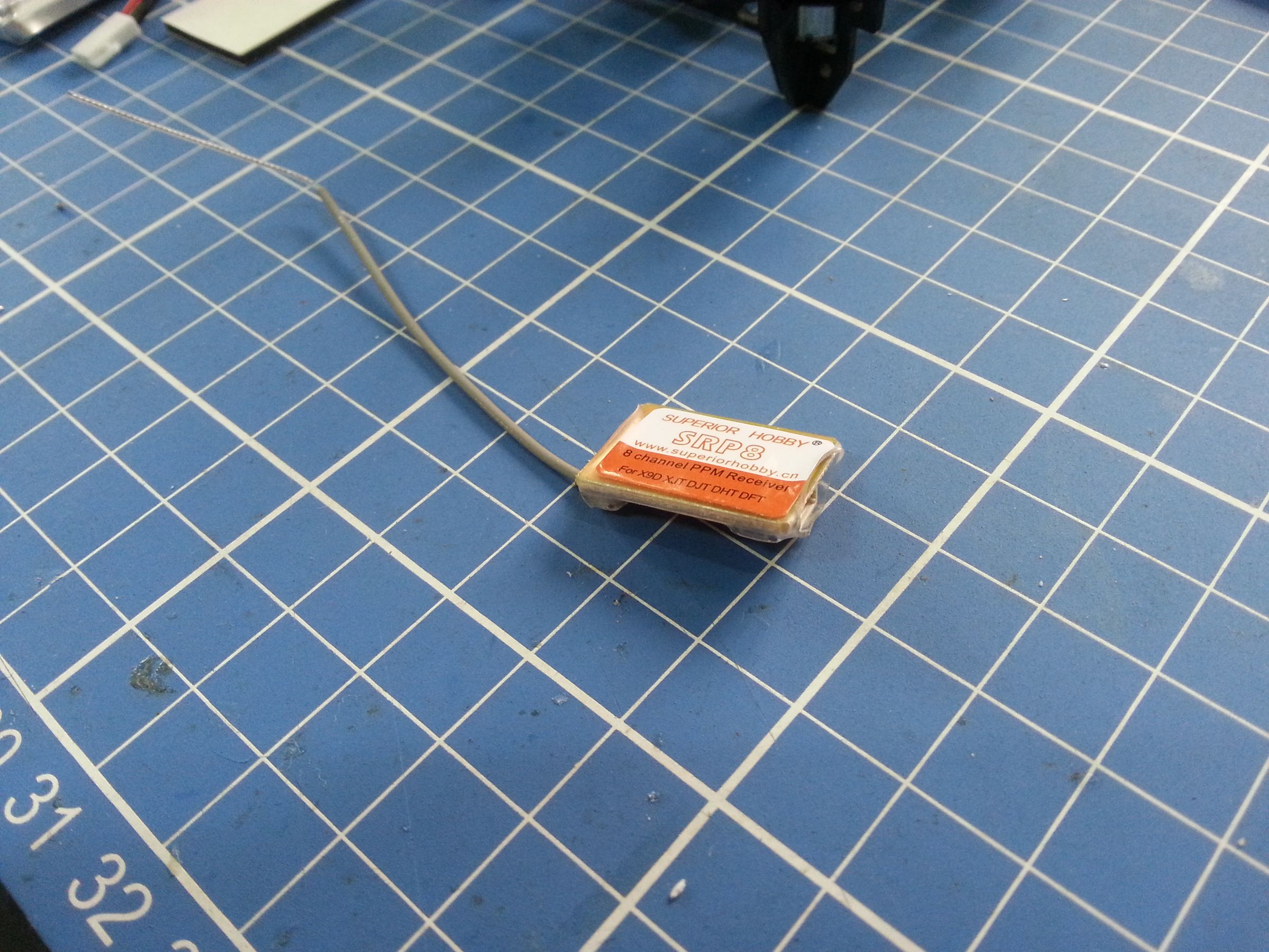

Again the kit did not come with a receiver, but good thing I have a spare Frsky rx
It's an 8ch PPM Frsky Rx module

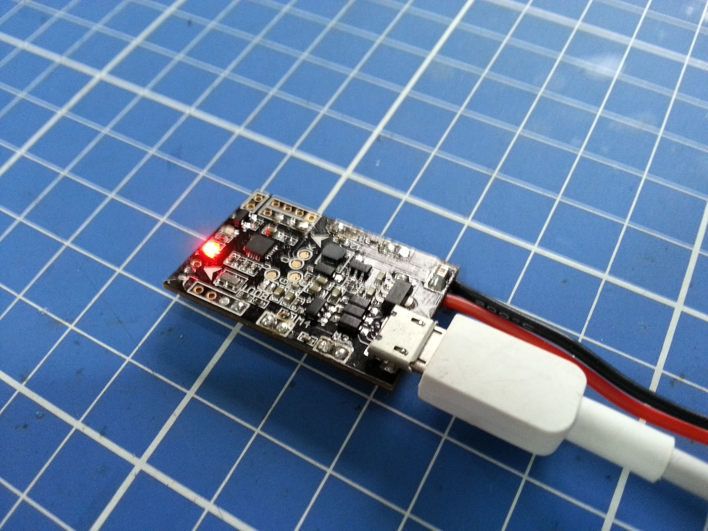

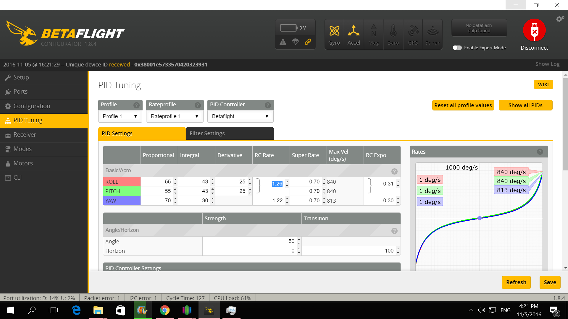

To set things up you will need to charge batteries first, while waiting for it to charge we need to make sure that our laptop or desktop is able to communicate with flight controller of the micro quad. The flight controller of the quad is based from thr SPF3 Evo Series. And since the micro quad itself is standard you can use my PID settings for your QX80

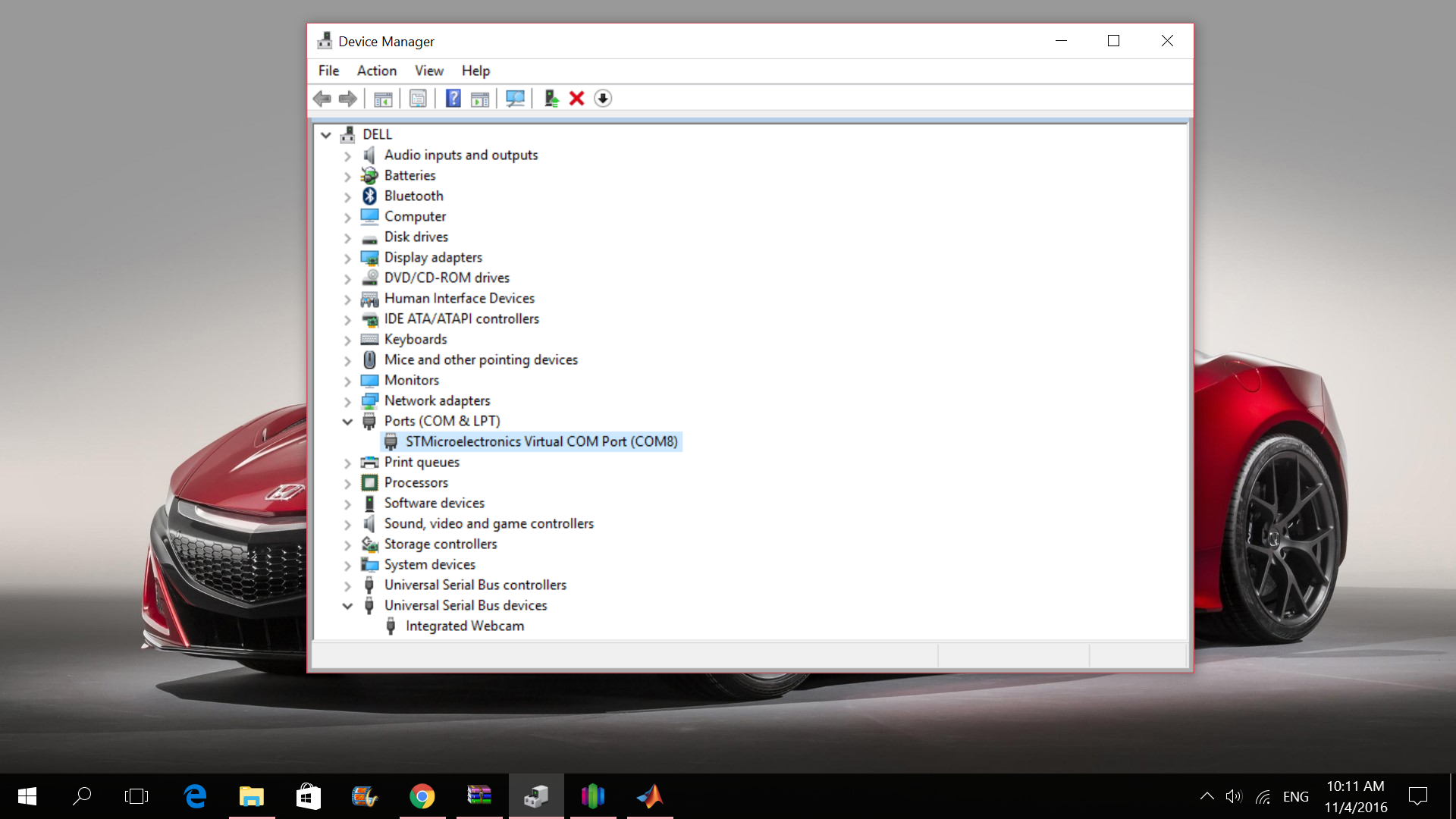

Connect you flight controller into your computer and make sure you have internet connection for it to automatically install the driver.
Go to your device manager to make sure that your computer is able to communicate with the FC
I uploaded A quick video that should help you Flash your Flight controller to the latest firmware.
You may or may not need to use Zadig.exe in my case I did not need the Zadig.exe which replaces the driver of a USB device.

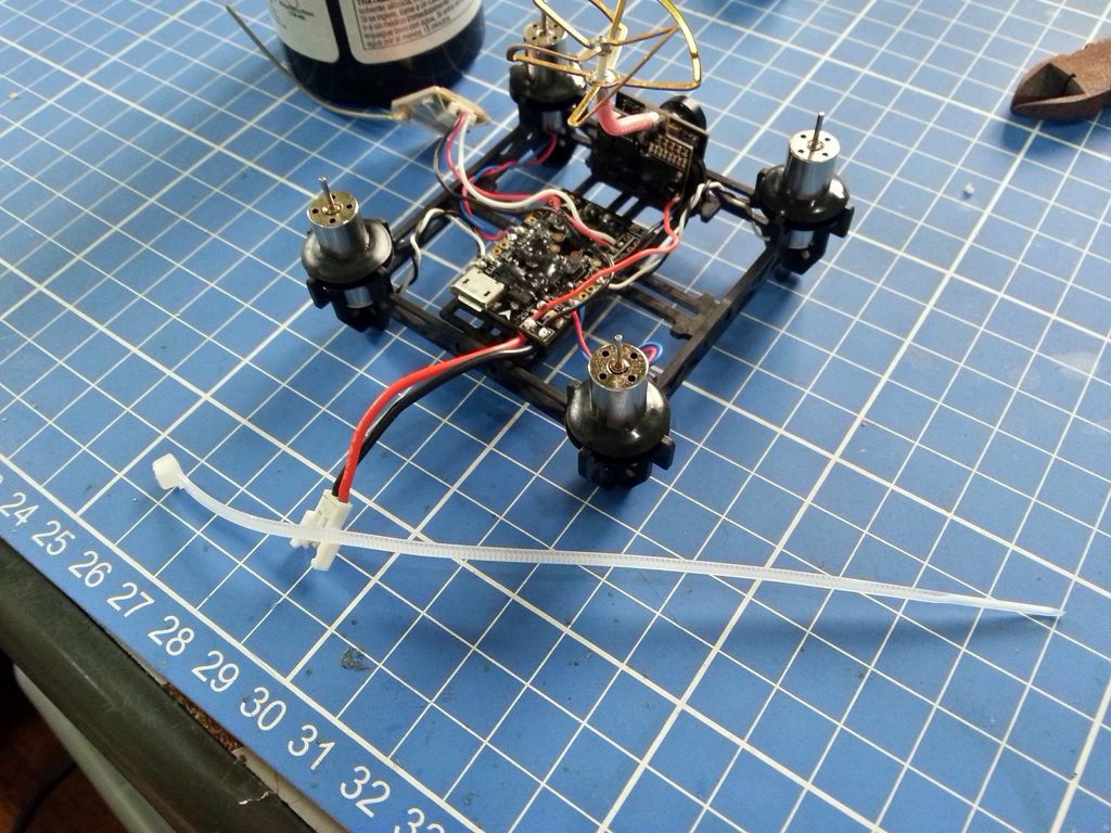

We only need to solder 3 things in this step the +, -, and rx pin
So get your soldering iron ready.
There are a few Receiver boards out there in the market and each one has a different protocol to communicate with the flight controller.
In my case, i'm using a Frsky "PPM" protocol. To start this step we will need to trim the receiver wires to fit on top of the flight controller.Looking at the picture above we will use UART2. Solder the wires on the pads of the pcb respectively. and thats just about it.

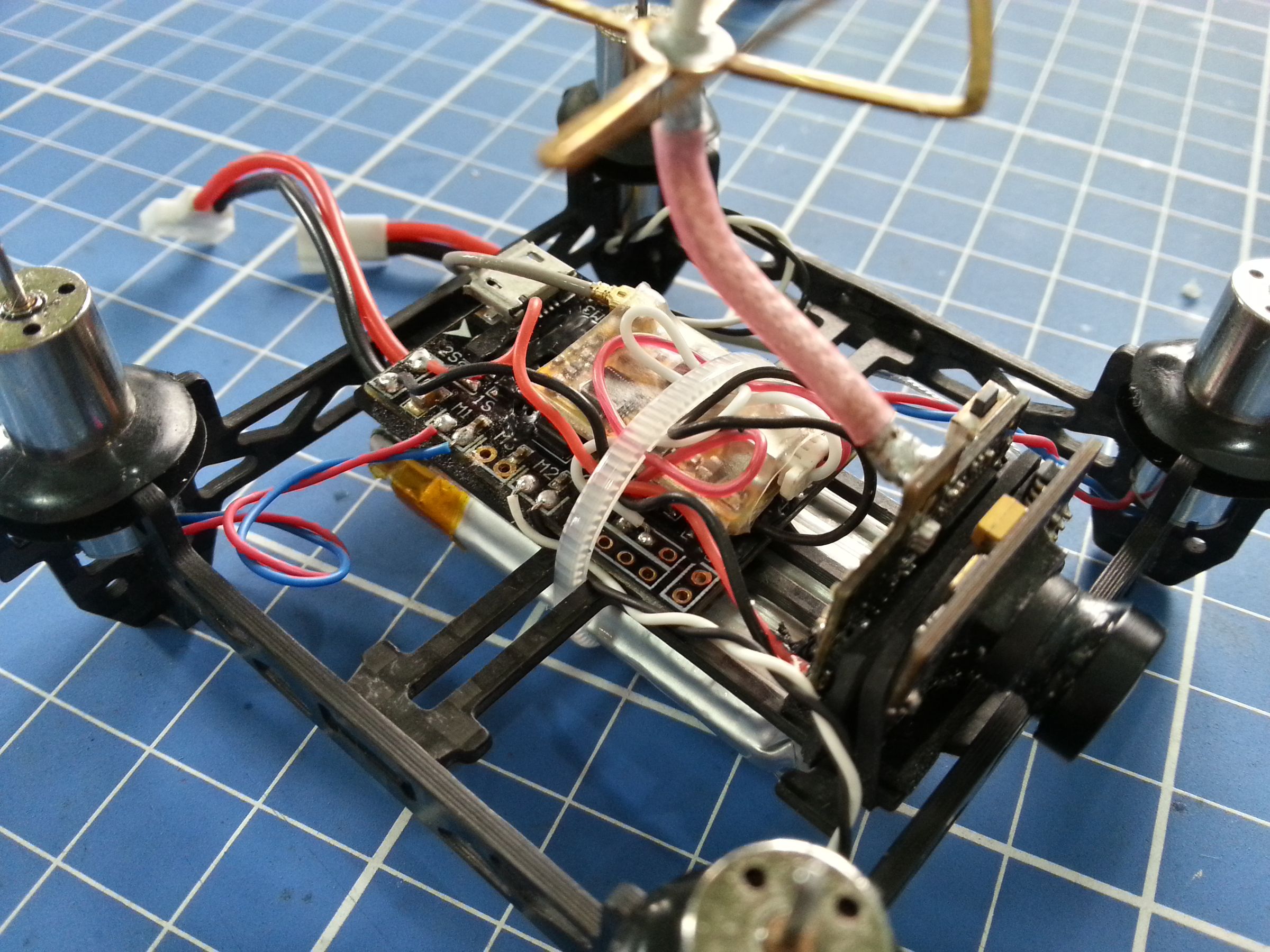

Crashing can make your FPV cam lean backward and get shorted from the flight controller or the CF plate so apply a generous amount of liquid tape, enough to cover the sensitive parts.
Step 4: Final Touch

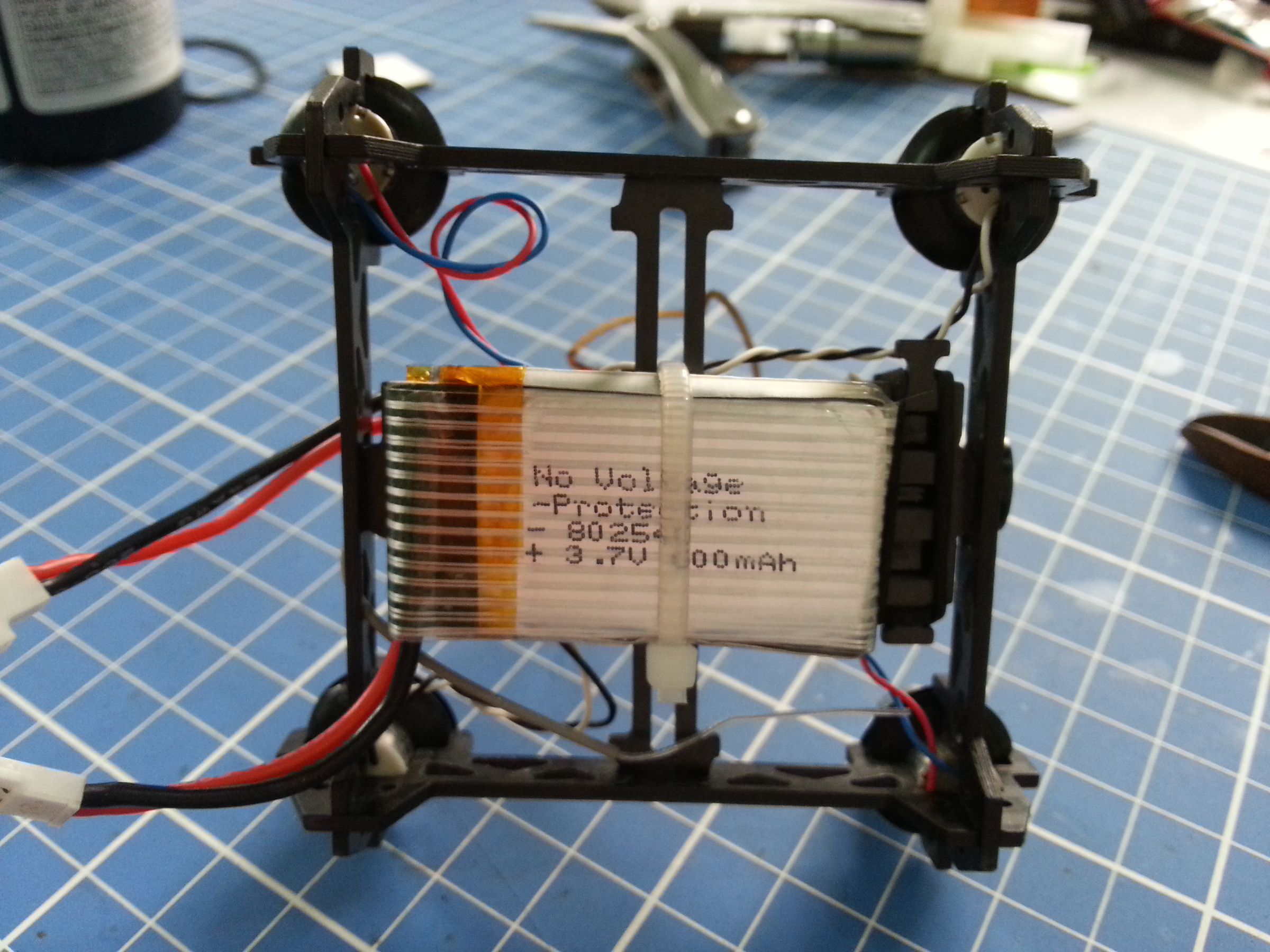

Basically it comes down to putting the receiver on top of the FC with a Nylon Cable tie
Usually, you would use the rubber band that came with the package but I don't think it's enough to hold the battery after a crash.

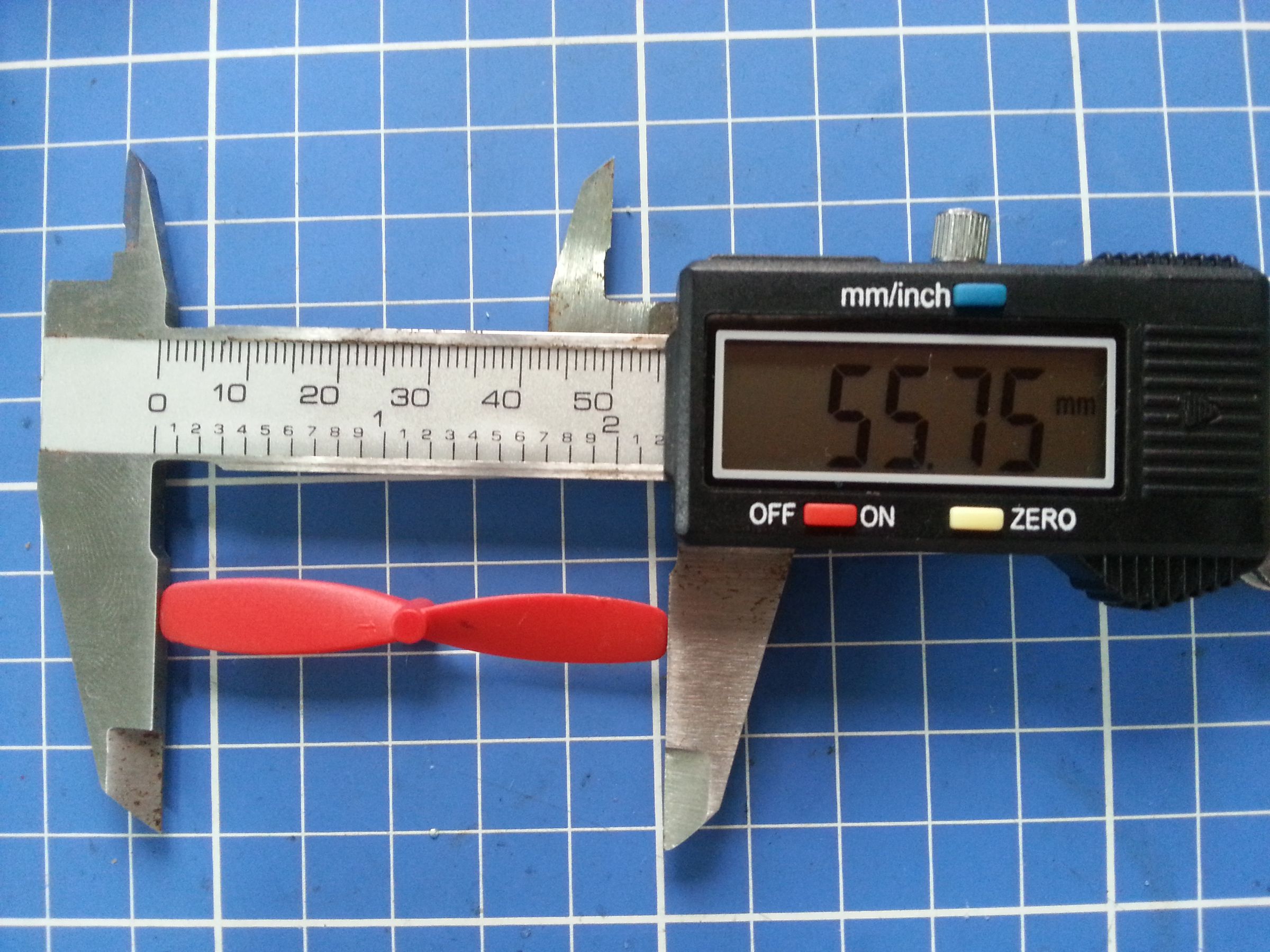

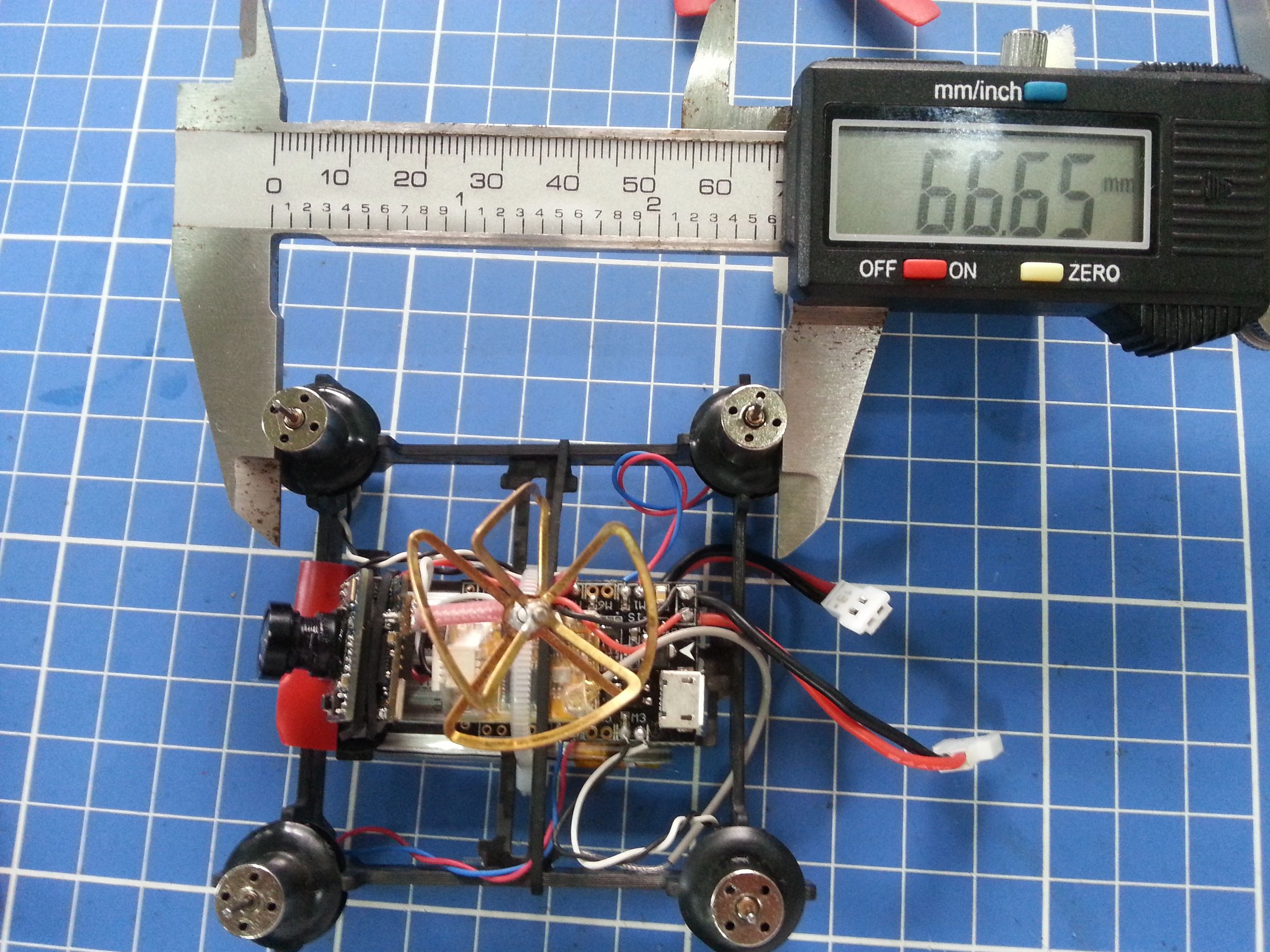

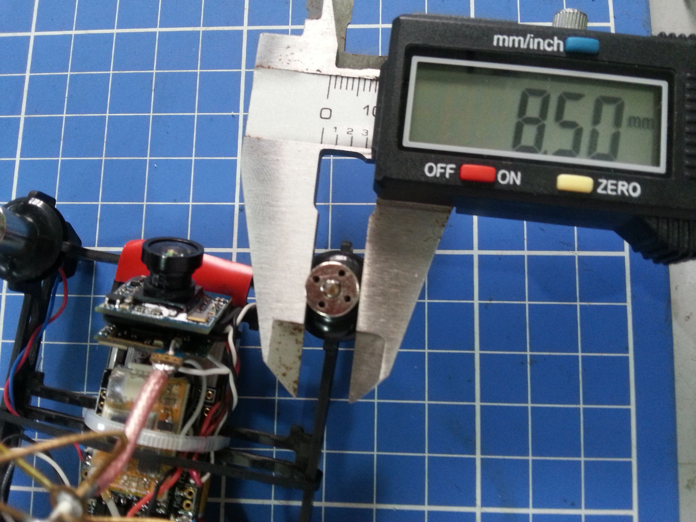

Basically, I just need to get the exact distance from center motor to center motor. I know that it says QX80 as in 80mm but that is just an approximate value.
This will also big role for designing the guard

Make it hover using ANGLE mode and make sure the stick commands feel good and crisp. The Pitch and Roll should follow your command and if the quad feels too fast or too slow connect it to your computer and go to the PID settings to decrease or increase the rates
