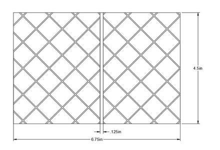

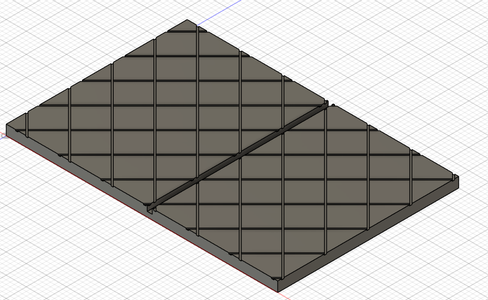

For the floor of the library, I designed a 6.75" x 4.50" x 0.25" piece with diagonal lines cut into it. I also put the slot for the two-way mirror in the floor and made sure it lined up with the top piece in the final assembly.

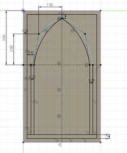

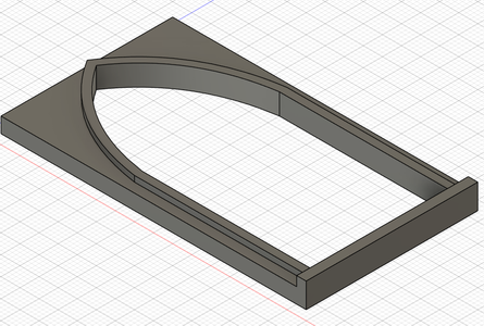

The front piece of the nook, I designed to be an arch to give it a medieval aesthetic.

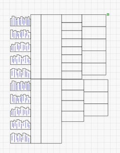

I also had to design tiny bookshelves for the actual library. I designed these to be made using laser cut pieces of the 1/8" MDF panel. The books I also designed for the MDF by creating a sketch that looks like a bunch of books.

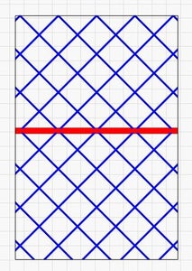

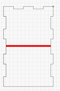

To laser cut these pieces, I make a drawing of the panels in Fusion and exported it as a DXF. I imported the DXF into Lightburn to laser cut them out of 1/4" thick maple wood. To cut out the slot on the top piece, I used an offset fill. For everything else, I used a normal line cut. After they were cut out, I made sure they fit together and sanded the surfaces to get rid of the burn marks and to make them smoother.

To make the floor, I did the same thing I did with the sides and brought them over to Lightburn. I used the same offset fill for the slot, but a less powerful one for the diagonal lines. After it was cut out of the same 1/4" maple, I sanded the burn marks away.

I used Fusion's manufacture workspace to create a toolpath for the CNC router to cut out the front piece. After exporting the toolpath, I secured a piece of 3/4" thick wood in place on the CNC router using screws and a drill. When the CNC router was done cutting, I unscrewed the wood from the machine and had to cut the edges using a table saw. To get the front to fit just right, I had to use a spindle sander to sand down the edges.

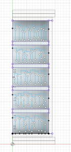

In Lightburn, I used the rectangle tool to make the correct number of pieces I needed to laser cut out with the correct dimensions. I also exported the Fusion sketch of the fake books as a DXF and imported it into Lightburn. After laser cutting them out, I sanded the edges and used super glue to assemble the tiny bookshelves. The overall dimensions of the bookshelves were 4.75" x 1.50" x 0.75".
