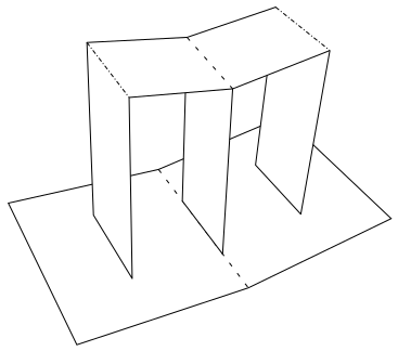

Standing structure:
The standing structure is ideal as a base for things like buildings. It consists of the base and a horizontal plane/fold parallel to the base. Both are connected with 3 vertical legs, 1 connecting the folds and 1 on each side of the fold. When the base is opened, the structure will stand upright. However, depending on the paper you are using and the weight on top of the structure, it might be necessary to add additional bracing to keep the structure upright. Multiple options exist to brace the structure. Most common is the double 45 degree fold (see next step) or adding a parallel fold between the outside legs (similar to sphere in next step).
Used as the legs of the robot.

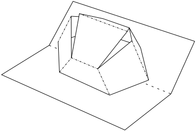

Semi sphere:
This one sounds harder than it is. But if we change the sphere into a polygon, it becomes much easier. Start with the standing structure from previous step. However, the two legs should now be replace with a semi circle polygon. The edges of the polygon are then connected using basic pointed edge parallel folds. Using a similar method it is also possible to expand the semi sphere to almost a full sphere.
Used as the body of the robot.
